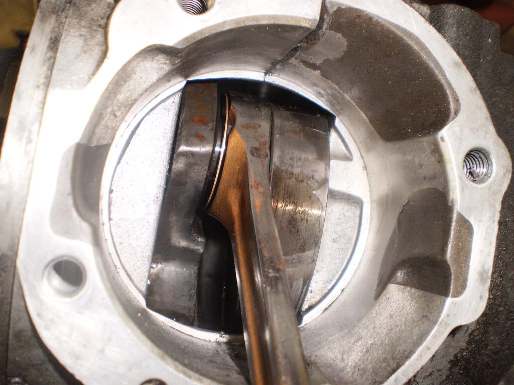

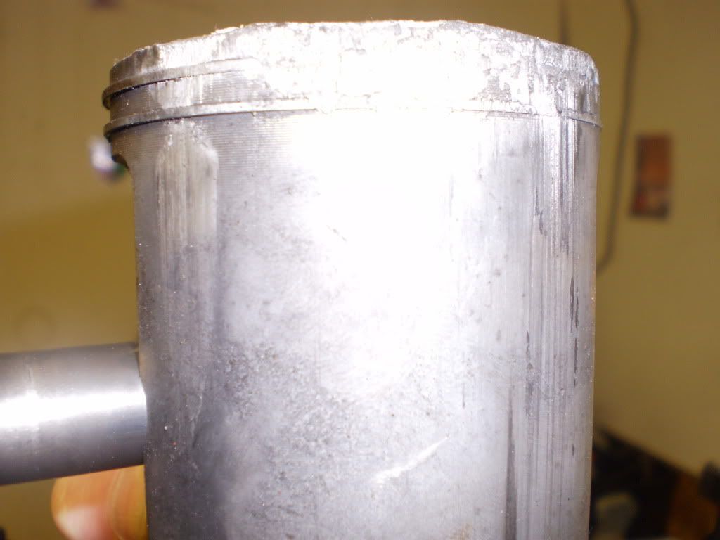

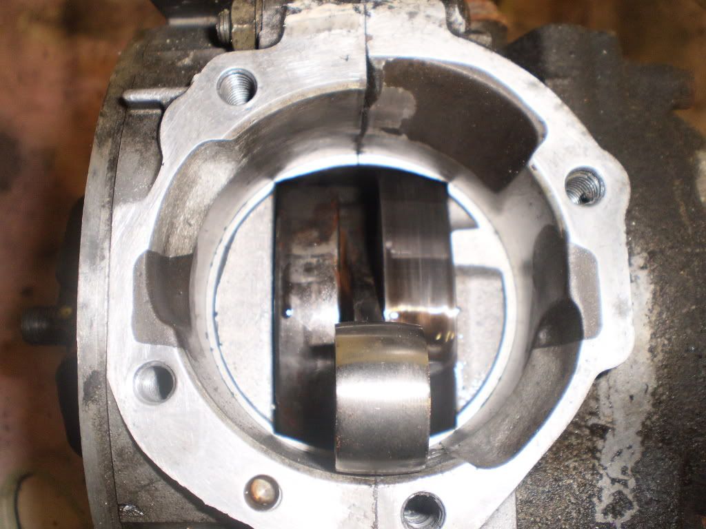

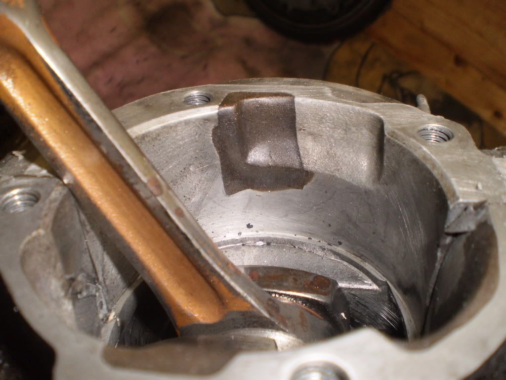

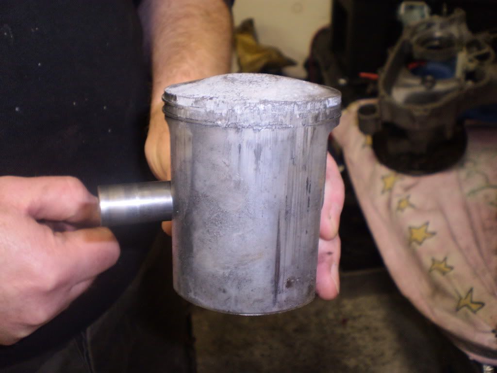

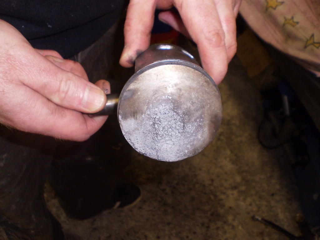

a mate of mine brought round his 210 malossi for me to have alook at first of my findings was that the piston was abit of a mess not sure what caused this see pics , also i found some interesting porting done on the casings does anyone know what this is all about as ive know idea as ive never seen this on any of the 210,s ive worked on before your thoughts on this would be great thanks Darren

looks like someone has went to a lot of trouble and epoxy filled the unused port elements to ensure smoothest possible gas flow up the transfers, nice job too if you aske me.

Transfers look fine to me. Piston says total lubrication failure. MIne did the same last month probaby due to crappy petrol with ethanol in it. Mine was running 3% fully synthetic premix and died within 5 miles of a fill of BP unleaded with ethanol in it. That engine had been bulletproof for years.. :|

That's been pinking it's tits off......... plug will be covered in alloy?
Either timing, bad fuel, too hot a plug or too high compression.
Doesn't look like lube failure or else it would also be scored on the boost side of the piston.
Nice porting by the way.
