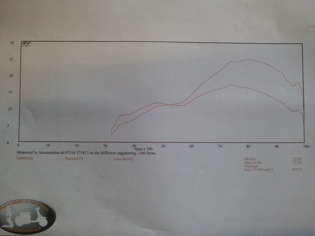

well we dyno,d this today and dan will post up the graphs/info etc as soon as he gets chance ..but I was pleased with the end results .
we also ended up having to use a 30mm delly PHBH carb simply because that was the only one that would fit using the MB reedblock ...we were gonna try an AMAL 34mm but even that fouled on the cylinder coweling .
sean brady scooters wrote: cylinder coweling .
i take it these manifolds are a lot shorter than the old style ??
its the angle thats the issue ..but no doubt a different rubber block could facilitate the use of other and larger carbs ...but the 30mm delly works just fine .

I have an MBD reed manifold on my Indian Ally barrel, if you turn the rubber up the other way you can get a PWK on. It has to sit at a slighty cocked angle and the petrol tap rod has to go between the choke and throttle cables but it works, you get an amazing downdraft and I am even able to get a Breathing Sweey filter on under S3 panels. I was using a 28/30 OKO pwk, not sure if the larger ones or even a Makuni would also fit.
