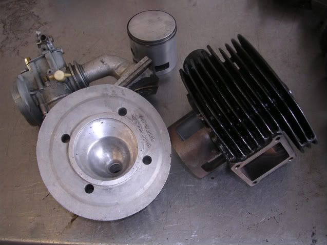

Here we go:
My Vespa P 200 E fitted with a Pinasco 225 Twin Carb cylinder kit, 60mm stroke crank, Cosa clutch, Scorpion exhaust,......

How does the engine perform? I remember the twin-carb kits being launched by Pinasco, but I don't think I ever saw one on the road.

Knowledge wrote:Very tidy Button.
It´s not a mind blowing or tarmac eating scooter but it´s going fine and since the scooter was ready for street use it never missed a beat.
I´ve tweaked out some more horsepowers by opening the ports (they are closed, there is just one port = like the original Piaggio 200 cylinder) and I fitted a cylinderhead with a better squish band and headvolume.
I still have one "nos" 225 Twin Carb cylinderkit as a sparepart and also one "nos" 177 Twin Carb cylinderkit.
If I ever find the time I will fit the 177 Twin Carb on a PX 125 engine.
