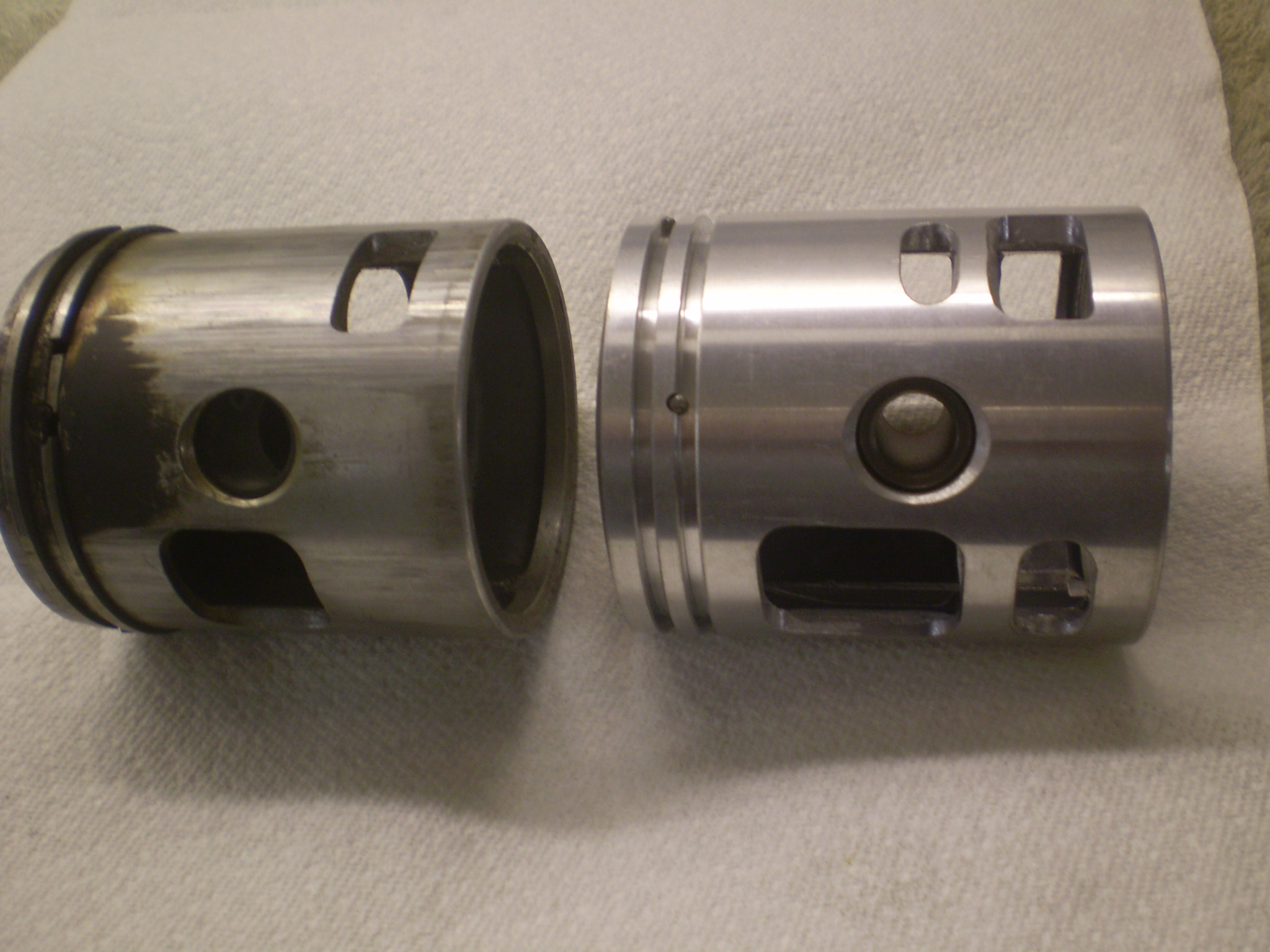

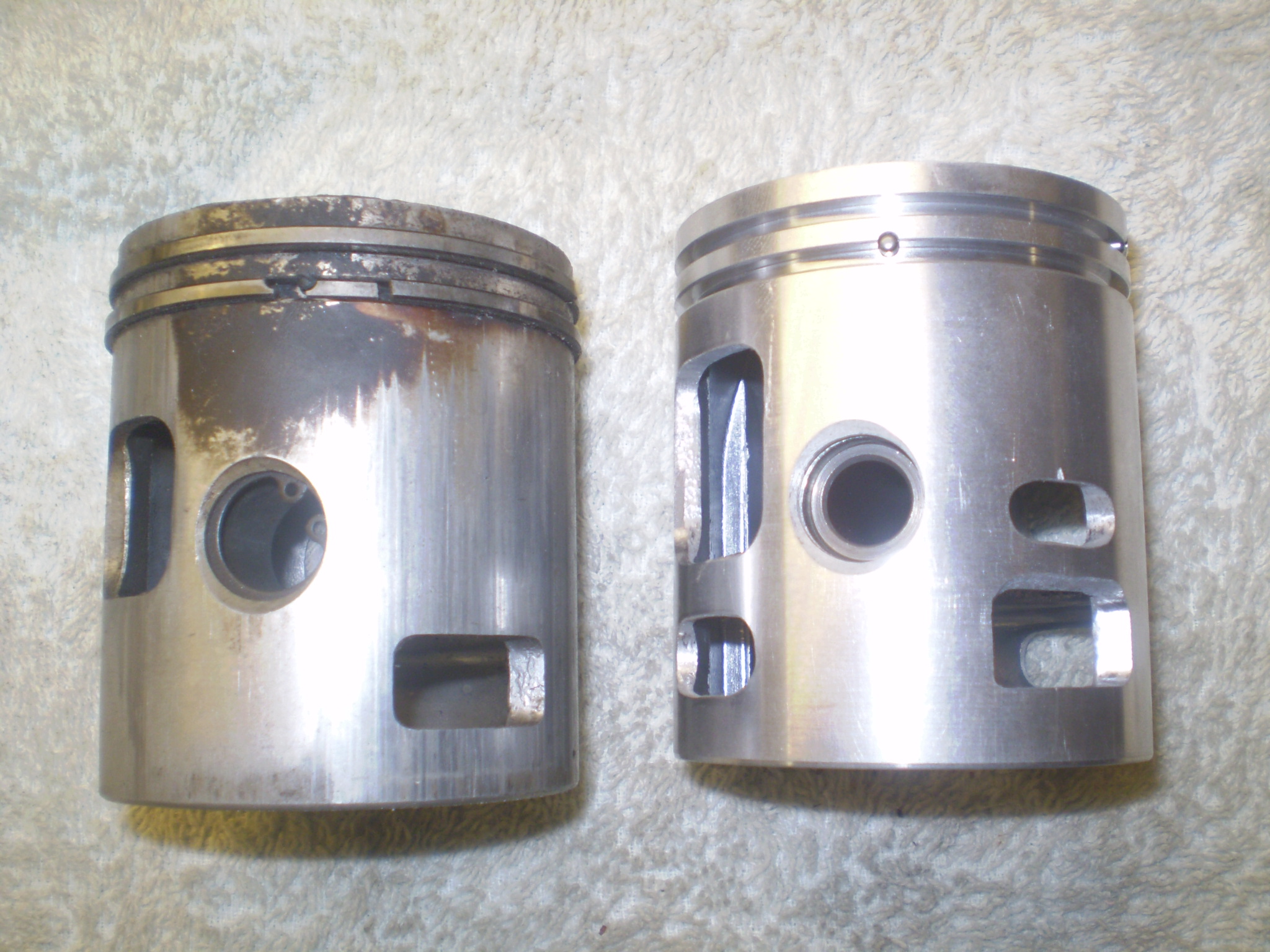

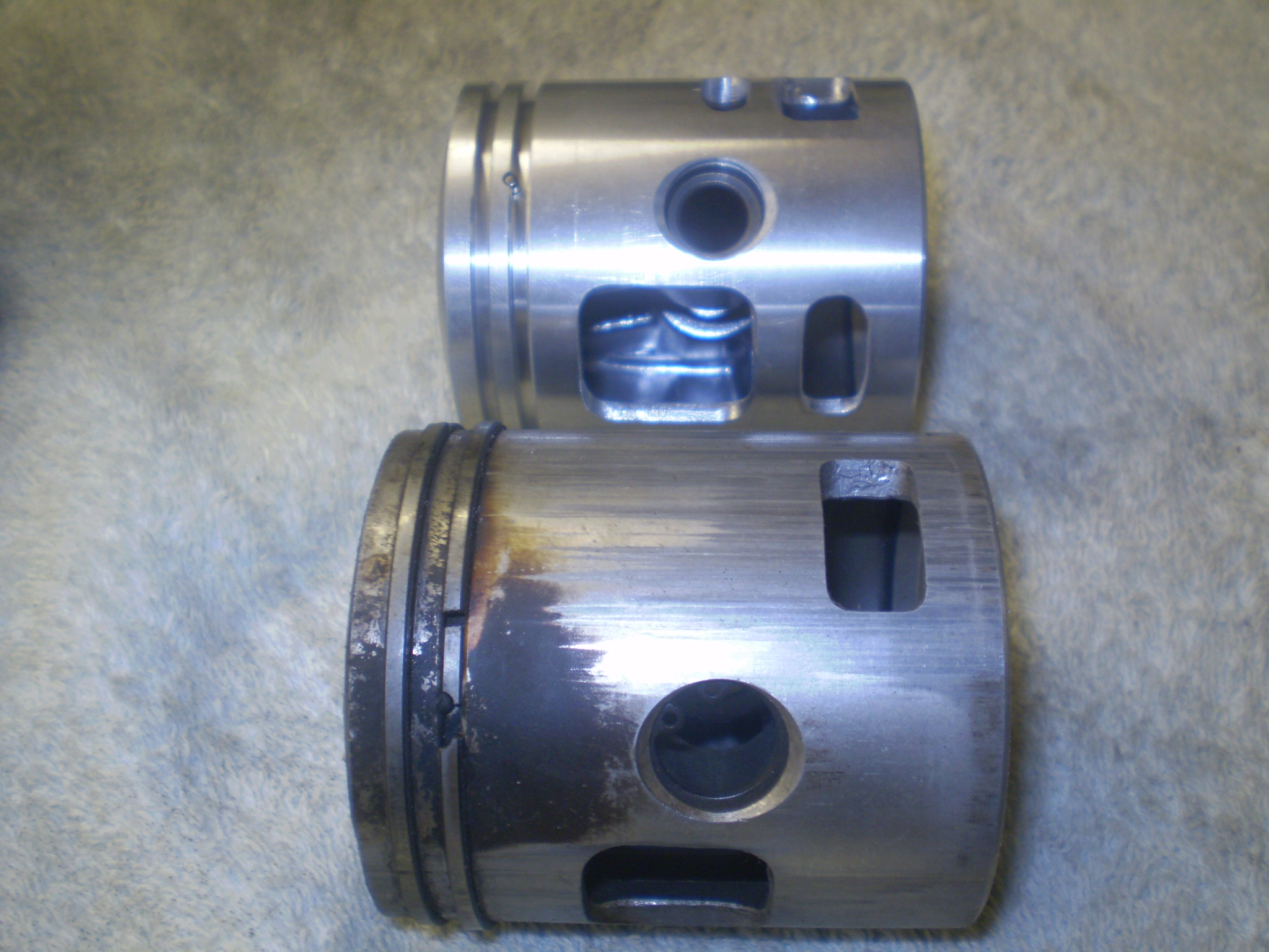

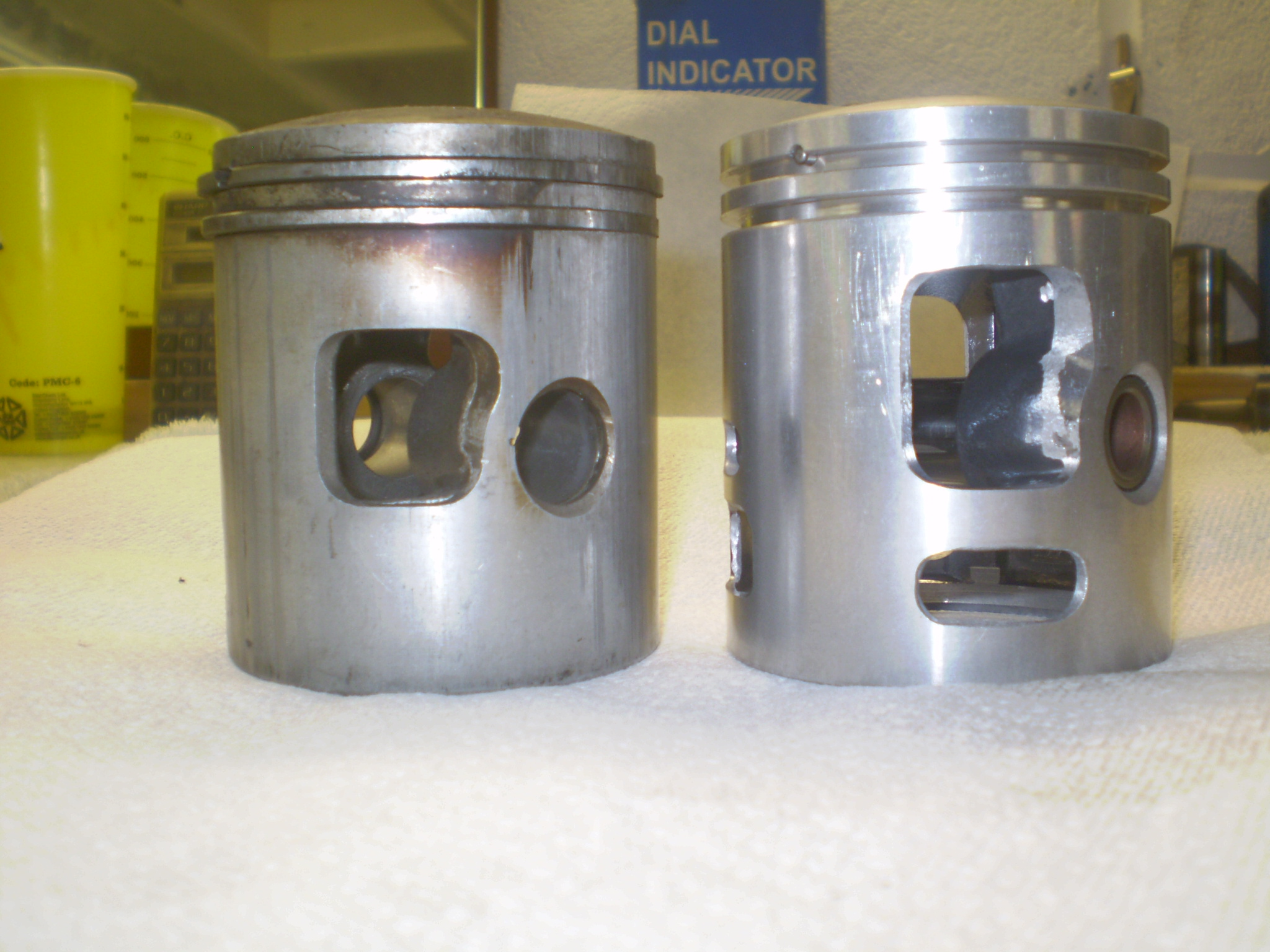

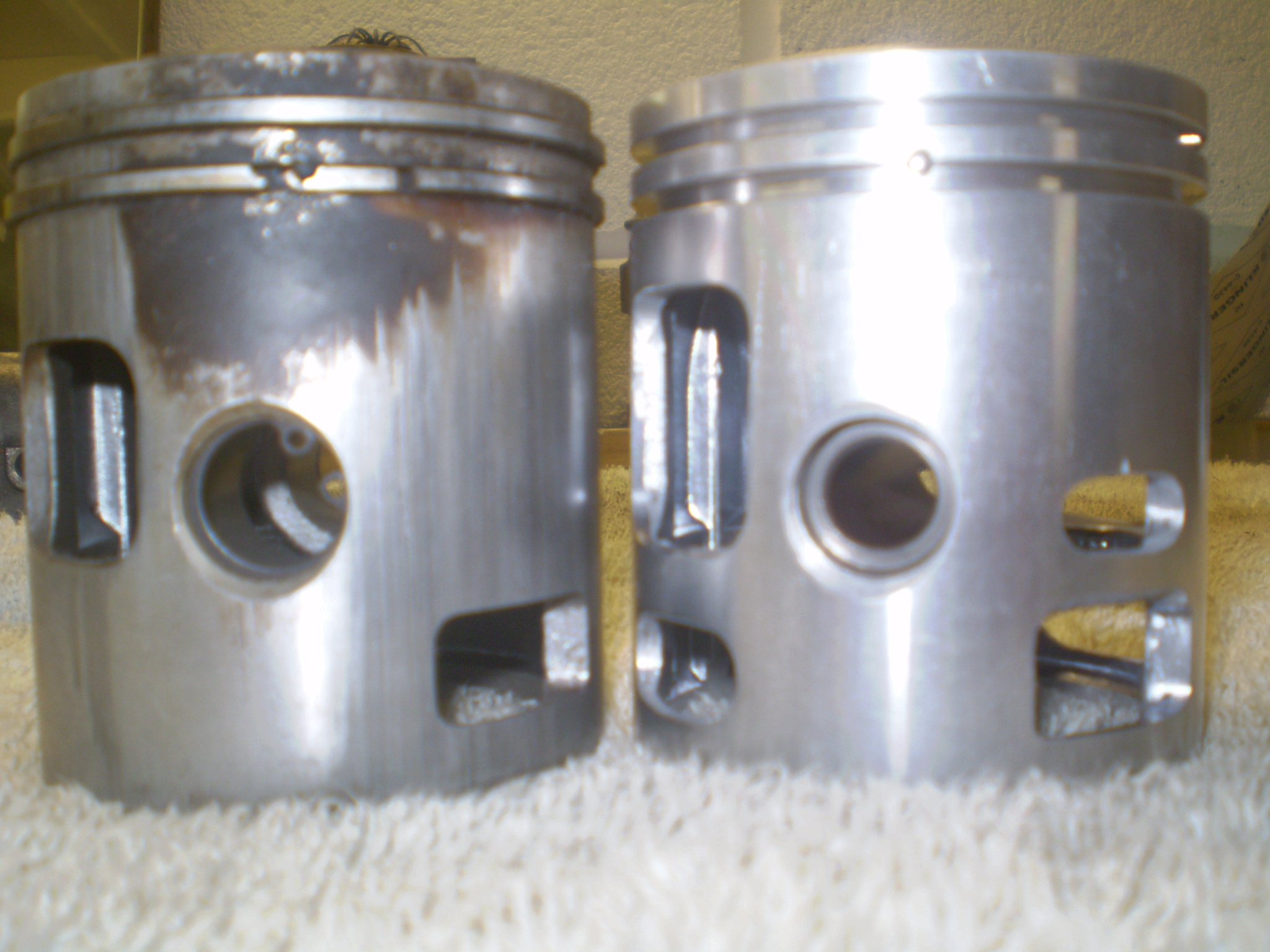

Standard P200, Andy just wanted a bit more power from his standard setup (already had sterling expansion chamber fitted) and kept the 24mm standard carb, i cut crank to 180 degrees, ported inlet area, ported the piston as per pics, and did a very mild tune to cylinder, then machined/lightened standard elec flywheel.......will dyno and post figures.
