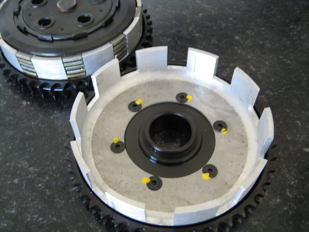

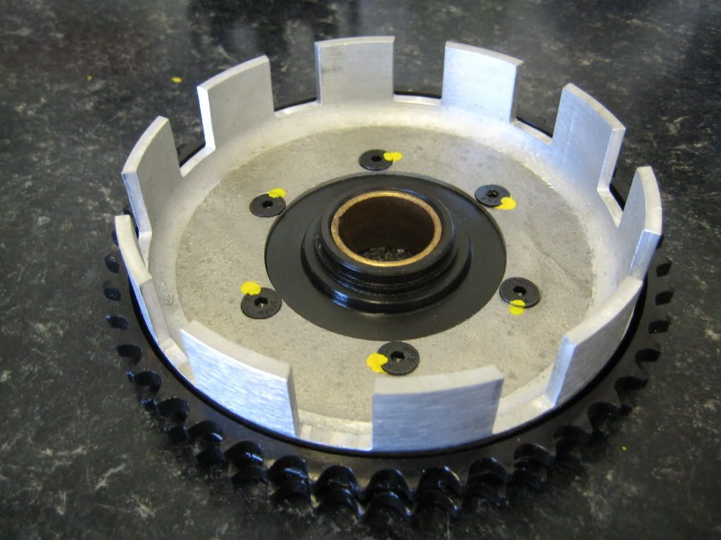

Hi , i do both 46 or 47 , as for the centres most 46 crownwheels are hardened but the 47 will be the bronze bush type and as for cost anyone who wants one from off this site then there 230 outright otherwise it would be 250 ! Pm me for details :D

right boys and girls , finally got somewhere with my own redesign ,no longer using aprillia baskets and plates due to machining time and availability , im now using a yamaha derived plate and my own cast basket that im now happy with , ive currently machined ten 5 plate 46 tooth clutches and am about to start on the 47 tooth version , cost is £200, £180 if you supply the correct exchange crownwheel ....
also i can machine the basket to individual spiders , ie foxhat , mb to make them 5, 6 ,7 ,8 plate motorcycle style plates !
pm for details .................... ;)

What kid of engine power has the latest design been tested with?

Hi paul ,the 5 plates are good for high 20s and out perform its lambretta alternative , i machined the five plates due to requests but the casting allows for any plate combination so it really is down to what the individual requires as theyre all handbuilt anyway !

what is the cast basket made of?
Craig H
Posts: 187
Aluminium I think
