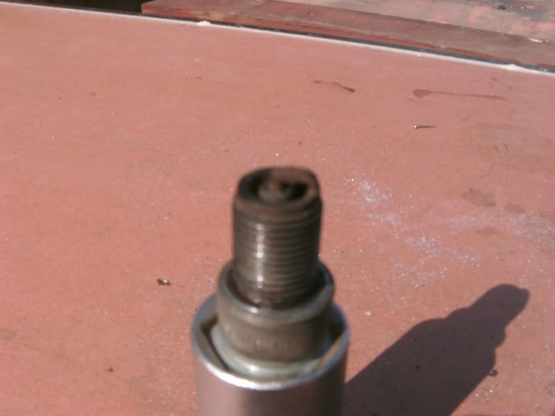

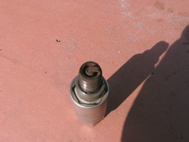

Rebuilt and run now for 30 odd miles, heres the plug..
Which looks quite good to me.
If the timing was out, would it not show on the plug?

soulsurfer wrote:What throttle position were you when your piston went and what position was your plug chop?
I know what your thinking Mike :lol: , was he giving it some and the PJ wasnt working, it had crossed my mind too, sounds like he,s only had any trouble since dropping the needle to lean it up lower down though. What plug were you running Peter.
peter357bikes
Posts: 61
Joined: Tue Jun 30, 2009 9:29 am
An N3C couldn't really tell its condition as it got blasted by the piston material...but looked very lean at first glance.
