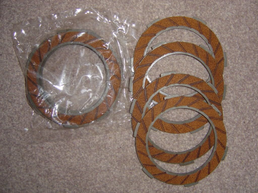

i use these from INDIA yes thats right :o there very well made and ive used them in an engine which had a rapido clissic top end a race rapide and then a ts1 fitted same clutch and gearbox same plates for well over 3 yrs scoot was my daily transport i also fitted alot of different carbs and pipes on all top ends it was a real test bed 8-) i used standard springs with an old set of vespa ones over the top and a yamaha lever with nylon lined cable i never had any slippage even 2 up which is more than can be said for the 5 plate that i tried the grove area is longer so more oil can go in there and its thrown outwards by the design these plates cosrt in the region off £5 from fanatic scooters in bristol and if im replacing a clutch on anyones scooter i use these as long as they have a 4 plate
What steels do you use with that clutch Steve. I have one of those that came with steels but they look stamped out of sheet metal :-?

dirtyhandslopez
Posts: 465
I like the look of them Shocky, the angle for throwing the oil out looks good. Still looks like there could be a bit of material removed from the grooves, could make them even better.
