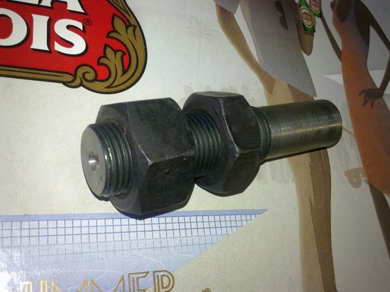

I done a couple of hubs and only took enough off to clean up the surface and all seems ok. Also I made up a little tool for holding the hub true, I can post some pics if you want.

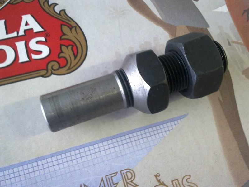

Hi Stu,
sorry for my lateness, there's nothing worse is there?
Anyway, here is my mandrel; works quiet simply really(I'm gonna slur cos i've had a couple of beers!)
It's a big bolt,I've turned down the head and shank to the nominal diameter of the small diameter of a layshaft spline.
I've turned a taper on a nut to suit the taper of a cone,the second nut is to lock and finally a centre drill in the end for a centre on the lathe. :shock:
