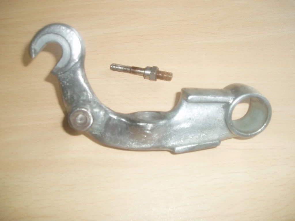

Sheared off damper stud in link
boonyed
Posts: 64
Joined: Sat Jun 06, 2009 10:45 am
Can anyone help please?
I have managed to shear off a damper stud in one of my fork links and although I live near the engineering capital of the World, I aint got a clue where I'm going to take it to get it removed!!!!
I want to try and keep the same sized stud so need to get this one removed, whilst protecting the thread. The stud in the picture is out of the other side, but the one still in there is right up to the hex.
Can anyone suggest an engineering firm that might sort it for me in the Black Country/Birmingham area or is there some kind soul out there who might have a go at it if I send it to them?
Many thanks in advance
BOON

cant you buy them drill things that drill in backwards from b&q some sort of screw remover
as it drills in it grips or something like that...
dirtyhandslopez
Posts: 465
Drill using 1/16th bit, add heat then penetrating oil, let stand then repeat, then drill with a 1/8th left hand drill bit when hot, It should come right out when the cutting point of the 1/8th bit catches on the edge of the hole the 1/16th bit made.
That's not going anywhere...
if you have no joy send it me and i will sort it how did it happen? also is it a welded on typei will do it for free so will cost you postage

shocky wrote:if you have no joy send it me and i will sort it how did it happen? also is it a welded on typei will do it for free so will cost you postage
Shocky
Many thanks....I got your PM, I'll give you a call tomorrow.
Cheers
BOON
ok make it after 10 if poss i like a lie in after a hard weekend :P
