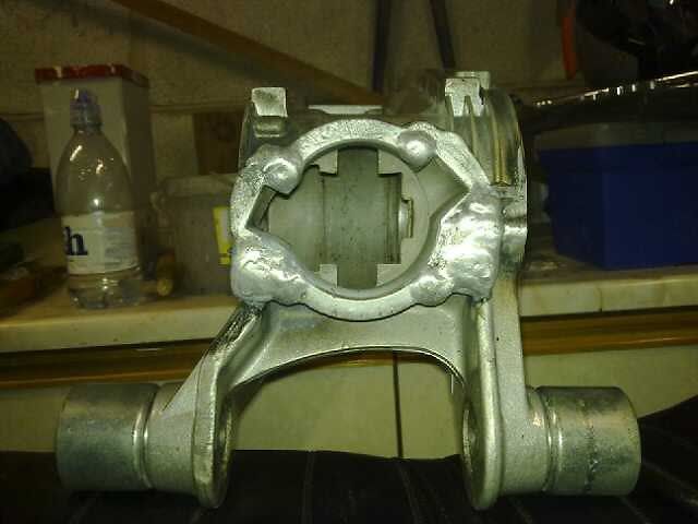

Well had them welded its a spanish 125 casing so ive had the stud holes welded as well, so i can redrill at 200 spacings then the mouth needs opening up
Next
What do you think?
Diablo
Posts: 614
Location: Nuneaton
I'm not a welder but there looks to be a lot more weld on those casings than when I have them done. I hope there isn't any distortion because of it.
carlos fandango
Posts: 792
Location: Stourbridge
Where are the main areas that would distort?
Diablo
Posts: 614
Location: Nuneaton
If enough localised heat is used without pre-heating the casing the spigot area can distort as can the mag flange area.
Like I say I'm no welder but the guy who does mine makes me break open the stud holes and grind out the threads before he welds them to prevent any voids.
Around the transfer area he lays succesive runs along the transfer I assume to prevent the case from overheating.
Someone who knows what they are talking about regards welding may well tell me I'm talking out of me arse :D
Diablo wrote:Someone who knows what they are talking about regards welding may well tell me I'm talking out of me arse :D
I have no f@@king idea about welding, but on the ones Sean has done, he builds in layers to avoid distortion. So either you're both talking out of your arses, or its just good advice. :D
J1MS
Posts: 1153
Diablo wrote:If enough localised heat is used without pre-heating the casing the spigot area can distort as can the mag flange area.
No its common sense with alloy welding it has to be spotless and any voids not fully welded will cause problems later, probably cause a void that could later crack and further pourosity... Its been a while sinse I did any Alloy welding, but Tig was the prfered method for a quality weld... It can be done to a high degree with Mig, and Mig does offer less distortion as there is less heat input to the surrounding area, but a good pre heating is needed first....
