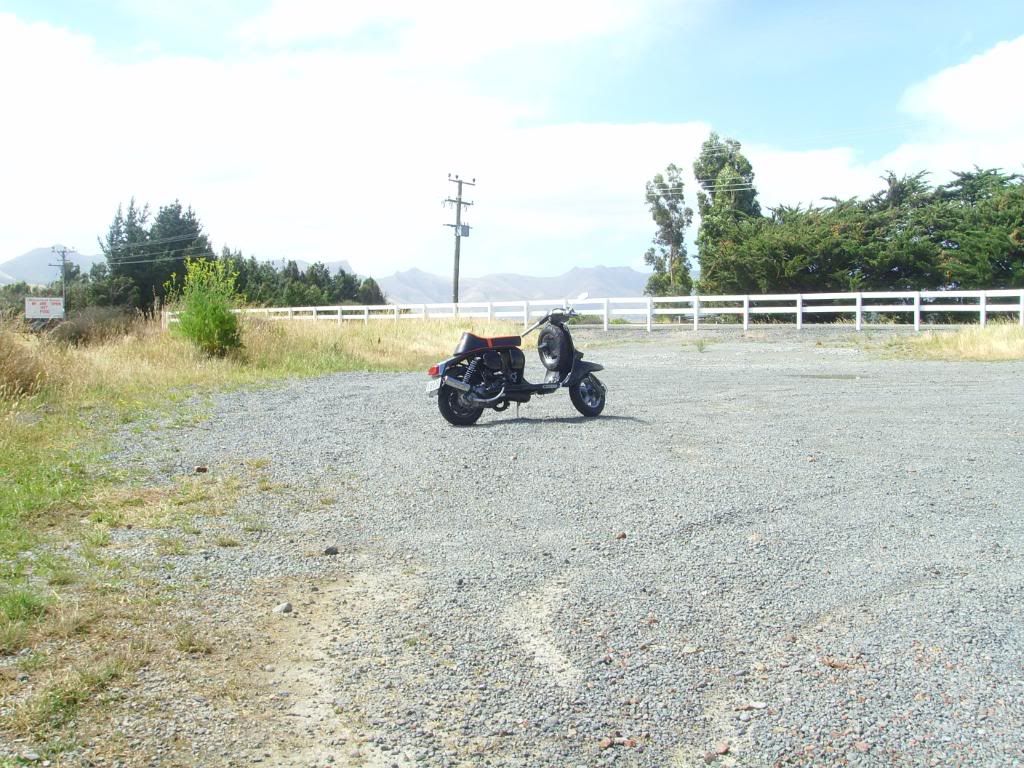

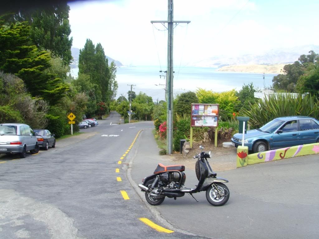

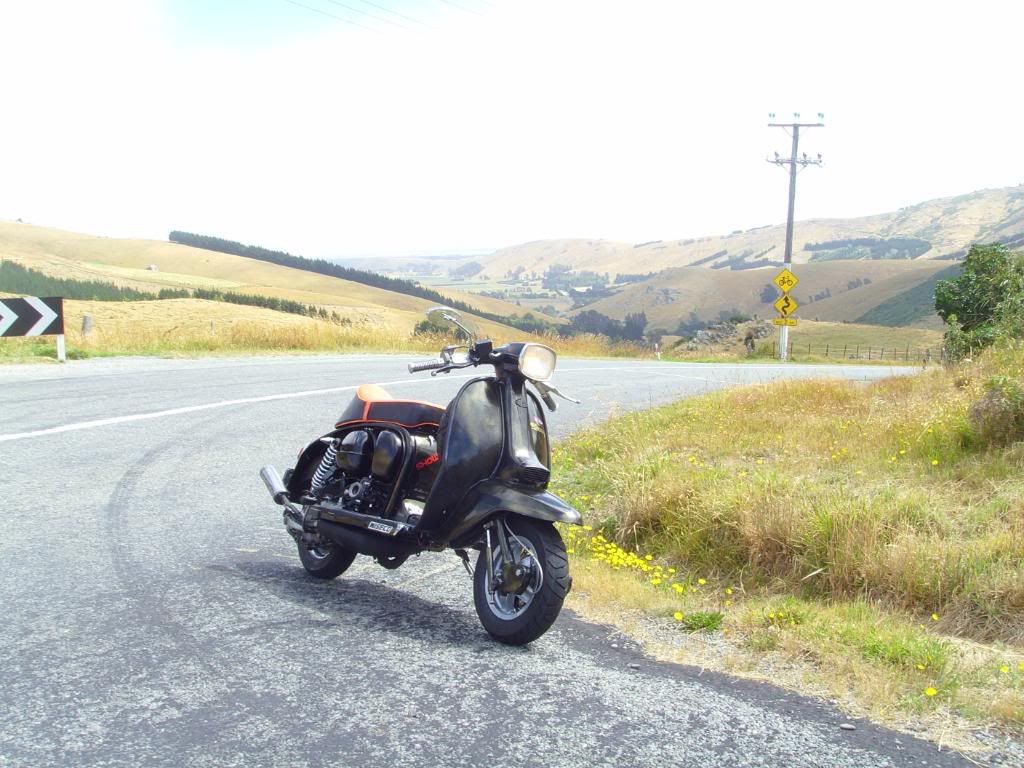

stolen from another forum :o :mrgreen:
I personally think that this front set up is both good-looking and a good improvement as you have the rim and the hub joined together in one piece, the only downside is that you have a different rim at the rear, so you have to chose which spare wheel put behind the legshields...or carry 2 different type of spare wheels :(
Dam

Hi Damdam,
Thanks for the pictures, I saw these of Scumdogs scoot down under and didn't even notice he had this disc fitted.
I was hopeing for some pictures of one of these discs fitted to a GP in black with normal type dampers and thats exactly what I got! 8-)
