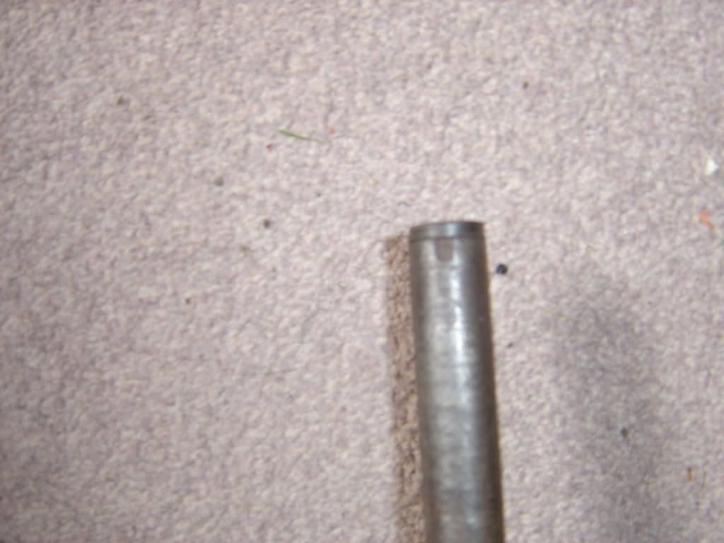

What's the function of the part nr. 56 in this diagram? Where does it actually go (does it just lay inside the throttle tube?) and is it possible to install it after the handlebar grip has been fitted to throttle tube?
There wasn't one present when I took the thing apart and now I'm little bit confused. I have a late model SX with plastic rollers etc.
its there to stop the control rod moving around it goes in the end of the handlebars not the throttle tube theres one on the gear side as well

Yeah, I know what part is in question, I was just little confused about the exploded view but your picture was very helpful. Thakns!
