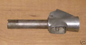

You could use one of these Indian indicator switch housings for your switch. These come up once in a while on Ebay. This one I got for £15. Finding the correct switch would take a little more digging maybe. SR maybe a good place to start.
