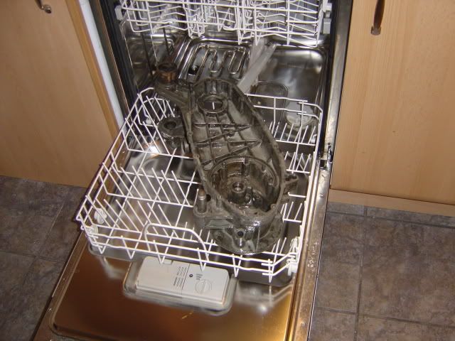

i use the dish washer but only when she is out

i live on my own :lol: remember to turn the salt of though :oops: it wont remove it all but helps i soaked mine with jizer first and removed all the big lumps
