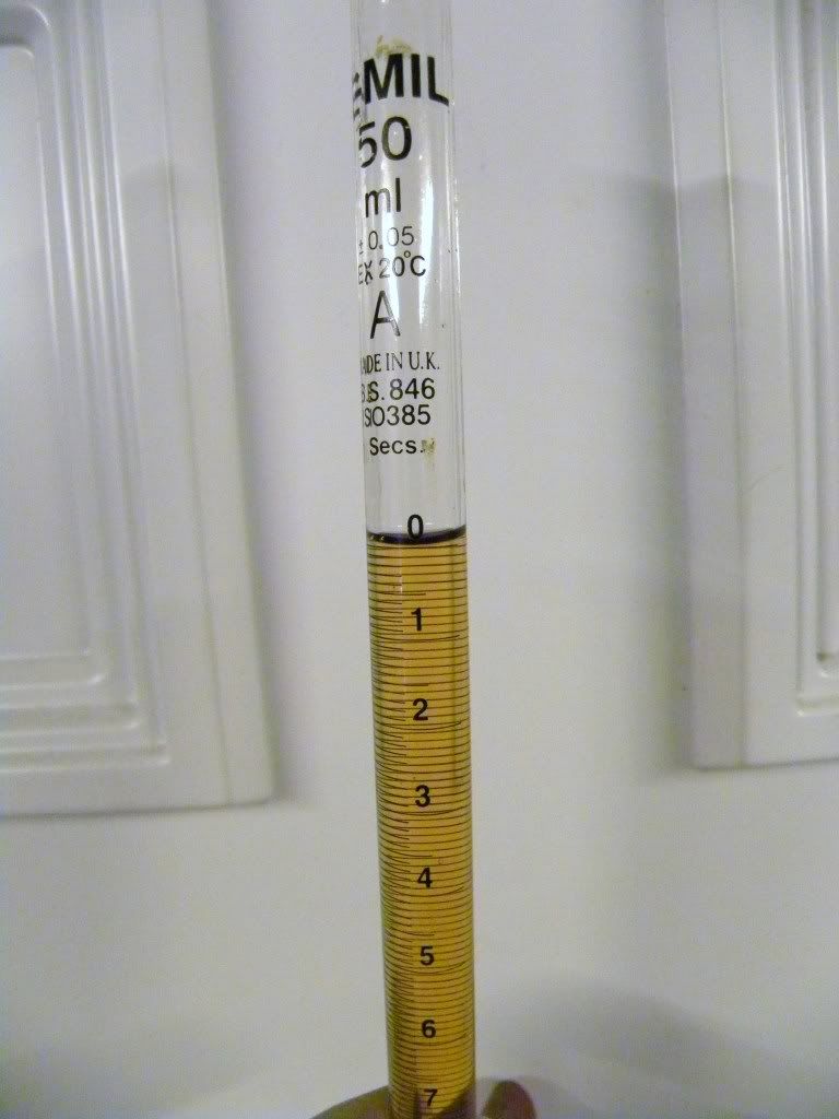

How the volume was checked;
I used a Burette, this is an accurate measuring device, marked in increments of tenths of a cc/ml. As can be seen in the picture below,

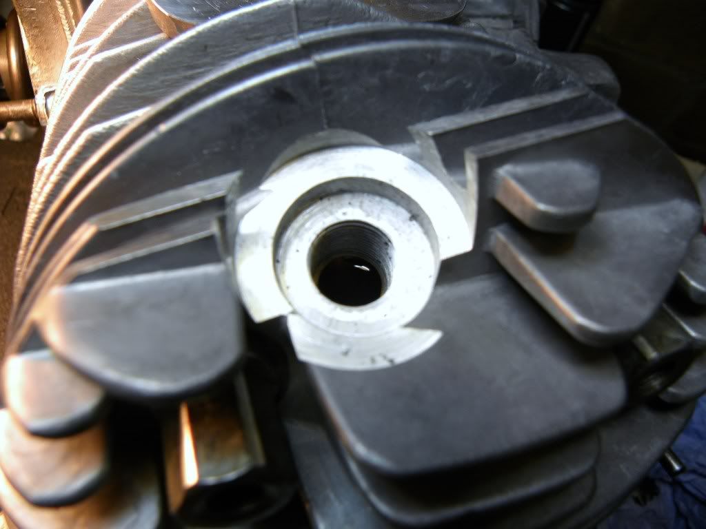

I use a mix of two stroke oil and petrol 60/40, then set the cylinder up so that the spark plug is at the highest point then open the valve on the burette to let the oil mix flow into the plug hole, so its filled the combustion chamber to the first thread of the spark plug. as in picture below...

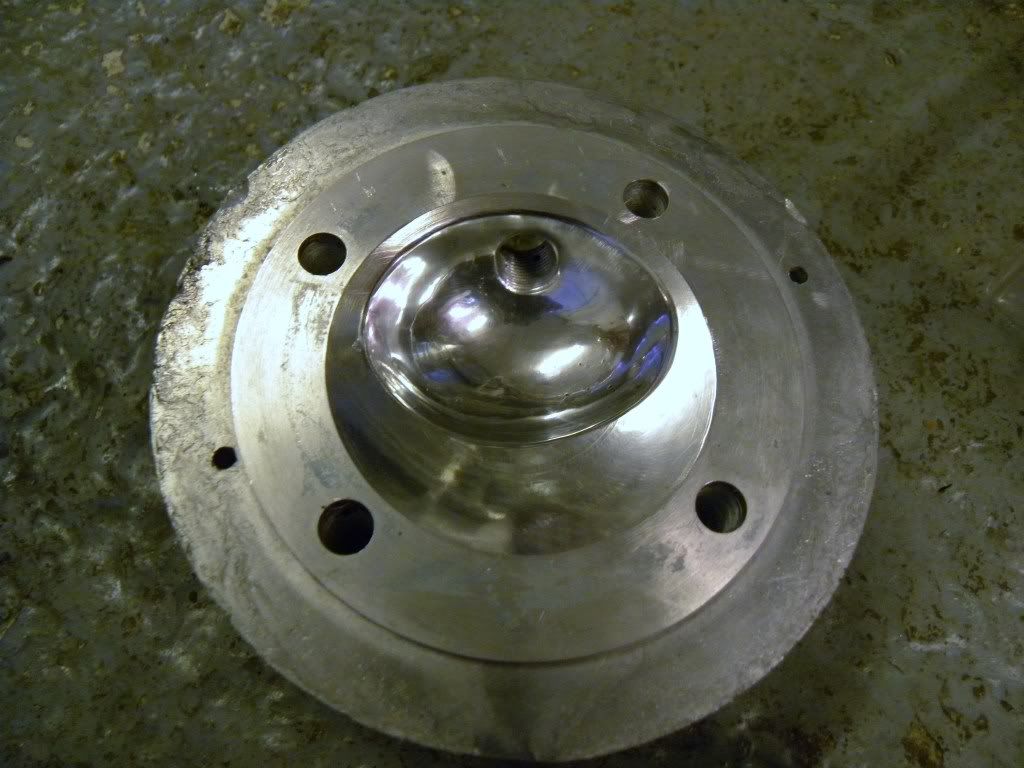

To lower the compression ratio the combustion chamber needs to be deepened or enlarged but without reducing the squish area (Too much) as this is part of the cooling for the piston crown...

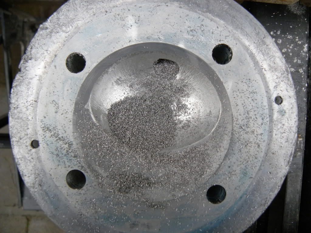

The best way (IMO) to remove material is by hand with a broad tungsten or HSS cutter then buff and polish I need a combustion volume when measured of 26.2. picture below after removing nearly 5cc of alloy..
Then buffed and polished a little to prevent carbon build up

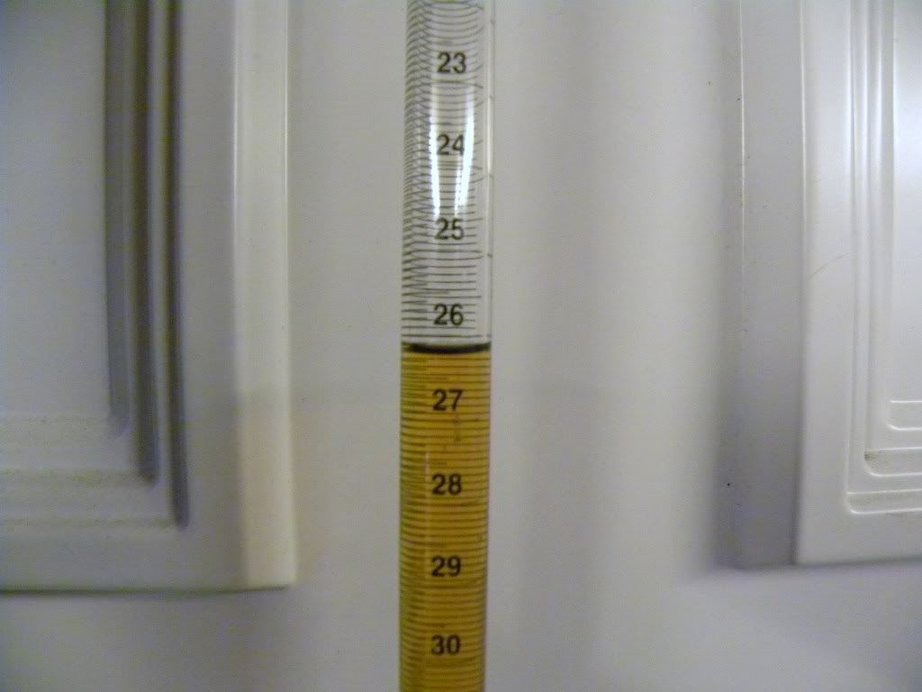

bolted back to the engine squish set at 1.2mm then checked with the Burette again and a reading taken as in the picture below...
The reading is the amount that has been run out of the Burette not the remaining amount...
