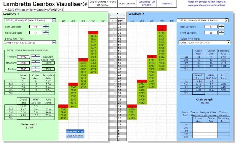

Barely any difference with the final drive ratio (4.98 @ 10.3 MPH/1000RPM to 4.81 @ 10.6 MPH/1000RPM)

Avantone wrote:Barely any difference with the final drive ratio (4.98 @ 10.3 MPH/1000RPM to 4.81 @ 10.6 MPH/1000RPM)
When do us mere mortals get our hands on the latest version of the gear calculator?
It's one of those things where every time you look at it, you think it could be tweaked a bit more. I still don't think it's as intuitive as it could be but I'll try and get the next version out this weekend, and then fiddle about with a further update if I think I can improve it.
Current version:
http://www.tonycassidy.com/Gearbox_Visualiser.html
