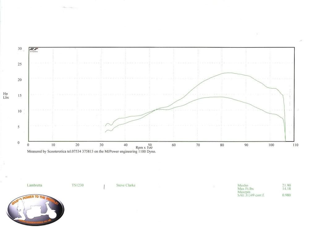

Took my TS1 230 to Dan last Saturday for a Dyno session.
I'm pleased with the results hopefully after the set up I can get more than 24 to a gallon. ;)
Nice smooth curve on both HP and torque :)

Power seems well up the rev range, whats the spec of your motor Red?

TS1 230
Indian GP200 19/46
Dell'orto 34mm Flatside (166 main,266 Atomizer K21 needle 2nd clip I think) I'll get the jetting details off Dan
Devtour pipe(Early skinny stainless)
Timing-Augusto 6000

Yeah,Jason built the engine.
When Dan put in on the dyno for the first run it gave a good reading and i think the only thing he really changed was the main from a 180 to a 166.
Apart from changing the needle as when he stripped the card the needle clip fell off as it was worn around the 2nd clip so it wouldn't stay on;)

Not jetting spec, spec of the engine :D Is it 70x60, 71x58, crank, rod, exhaust ;) But thanks for the Jetting anyway....

where does the rest of the graph go ? now our avatars are on the right, to me it cuts off at 7000 rpm, tho i can see it all below what im posting when i scroll down
