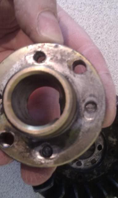

A mate dropped off this today to see if there is anything I could do with it. I thinks some new bolts and a spot or two of weld should do it. This is the 3rd one in as many years. It has totally destroyed the stator. Fitted to a TSI 225 going no more than 40 mph. Locked up the back wheel due to the stator coils lodged in the flywheel. Thoughts ?????
A new one is £137.

My wife's unwelded one did exactly the same in France a few years back. Common problem on 20+hp machines I'm afraid. Camlam don't recommend unwelded ones for TS1 or above - but they can supply welded versions at extra cost. Latest version has more and bigger rivets.
The other alternative is a Casa Lambretta flywheel which is basically the same ignition but the flywheel is one-piece.

Thanks guys, this one is the best of the three so far. It has better bolts than the other dead ones, the boss is tapped and nuts fitted to the spare threads poking through. New bolts and some weld then. Did'nt know about the Casa flywheel, thanks Sticky.

The 3 flywheels my friend has are all bolted. But the latest version of the three has bigger and longer bolts that have nyloc nuts on the spare of the threads. I think the new ones are riveted with 8 fixings rather than 6 as per the bolt on ones and add to this they are welded. So would have thought that should be enough unless anybody wants to go down the route of fitting a Casa one piece flywheel.
