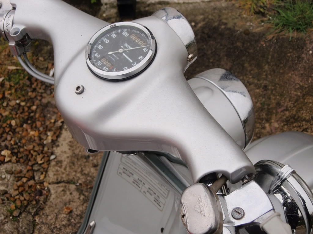

My Lambretta LD225 Rapido Retrospective S Type Thinggg !
Ripfx
Posts: 26
Joined: Mon May 25, 2009 4:57 pm
Location: South West (UK)

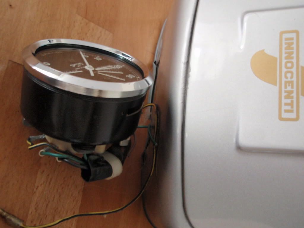

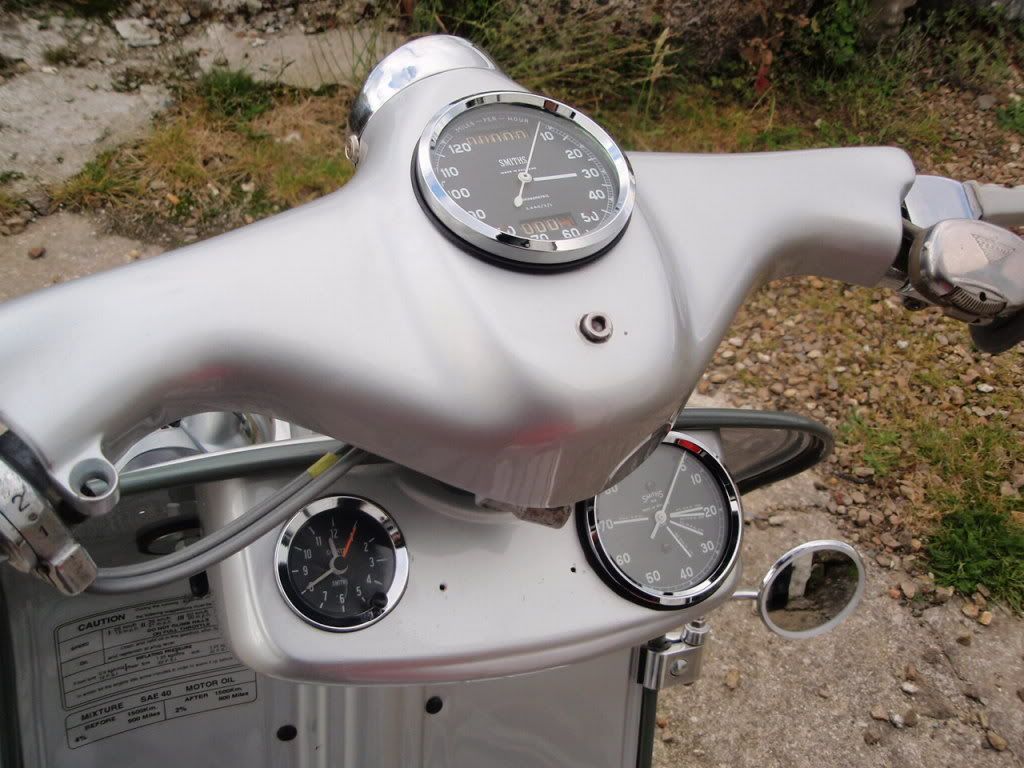

Rapido 225 Race, 30mm Dellorto,remote foam filter, Elec Ign,
Lucas Pathfinder lamps,SX200 damper forks, Innocenti disc brake, wide rims front & rear,
Smith Chrono Speedo, with Smiths rev counter(awaiting fitting in legshield toolbox)
Smiths Chrono rev counter case with Honda NSR electronic workings (so no need to take crank drive for cable)
S/S pipe (with micron sticker :wink: ) R1 shock, s2 kick start (to clear alloy floor extensions)
Awaiting battery before I wire the Pathfinders up(charging via Vespa regulator)
Now fitted with the toolbox holding the Rev counter, Ing switch and a smiths clock.
