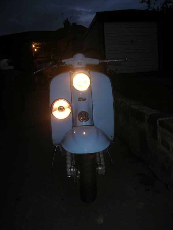

Afternoon all,
I've got a problem with my scoot, it keeps killing spark plugs. The first one it did was when I first put the motor in the frame and put that down to a bad plug, but so far I have gone through around 6 and only covered 600+ miles.
I've tried different makes of plugs bought from different suppliers and different heat ranges, and still they die.
I replaced the regulator as I wanted to run a pathfinder (for info for anyone wanting to run these the BGM 120 isn't up to the job).
I replaced the HT cap for one without a supressor in (from AF).
I guess the next stop is the coil, and then the stator.
When I take the plugs out they are well and truely dead without a glimmer of a spark (I've even tried them in another bike)
Has anyone else had any experience's like this / knows how to resolve it?
For info the setup is:
BGM 120 Stator (iginiton set at 17 degrees BTDC)
MB Lightened flywheel
MB Loom
Earth connections @ engine to frame, regulator to frame x 2, coil to frame, and lights to frame x2 (I've used a volt meter to check that they are good earths)
vespa 5 point regulator
ducati cdi
Spark Plugs tried NGK, Denso (long and short reach as I had the head skimmed, heat ranges 7 and 9)
Tried different HT Caps
Cheers
Mike
