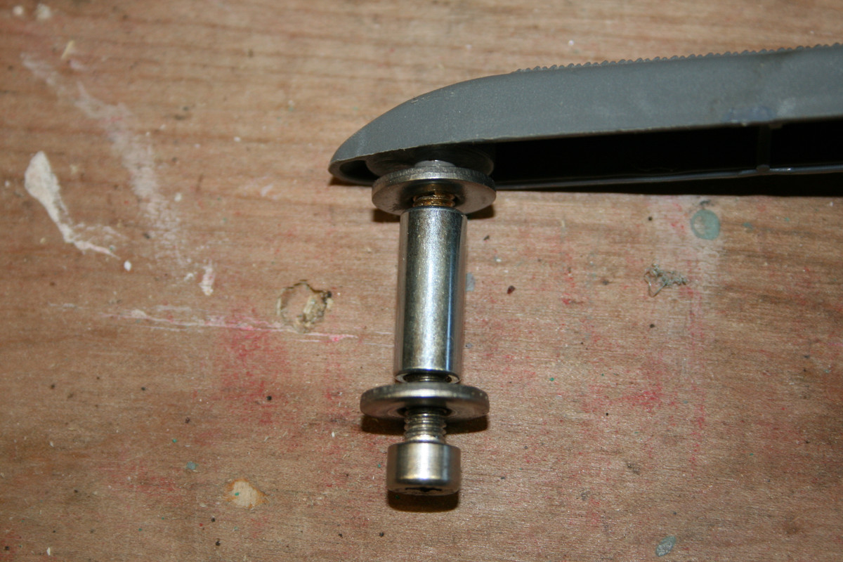

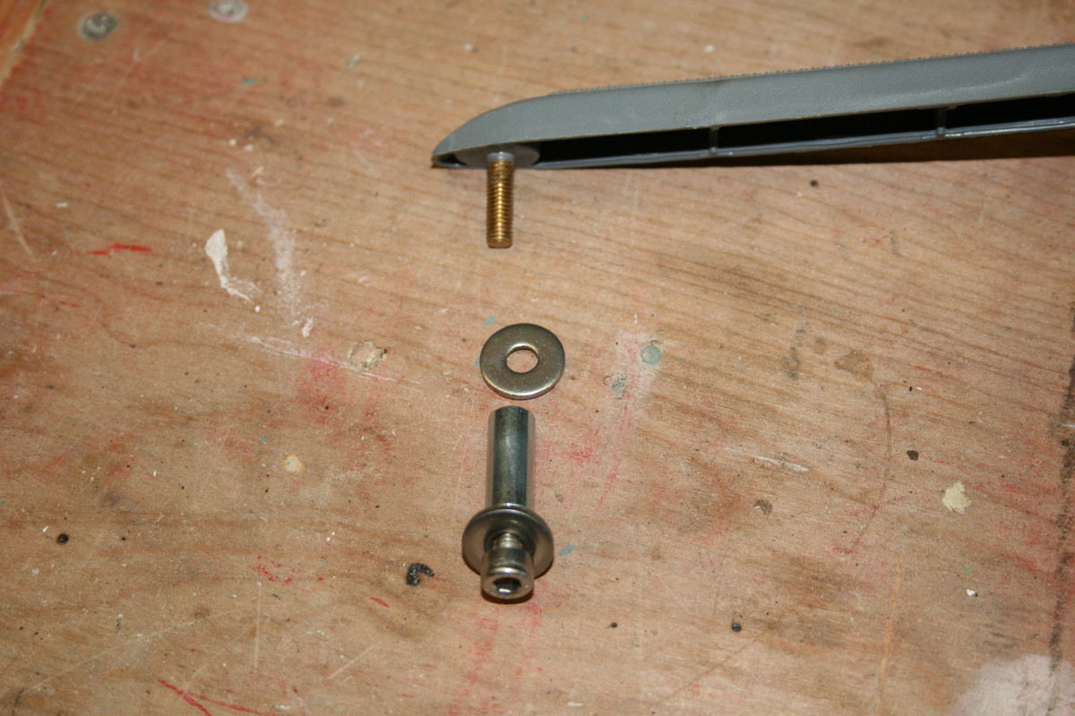

If I pack up the footboard it needs to go so high that I run out of thread on the rear runners. I've bought some threaded M5 (M4?) sleeves so could extend them(as below), but not ideal as it messes with the leggies as well and I'll have to put probably 10mm of packing under the main and front crossmembers to keep the floor level front to back..
Any ideas - this is the main thing I've got to decide on before I start repairing the front end of the loop and doing a proper dry build.

I had this issue with a series 2, u sorted it by cutting the metal plate next to the fuel tank, then cutting the supports on the hoop that where the coil fits, I used I thin blade in my grinder so it was only a thin slit, then I pushed the loop down at the rear, it just flexed at the front where the toolbox door is, and closed the gap to make it look better, a lot of faffing about but makes the end result look a lot better, thicker rubbers under the runners can help a bit too, good luck, and keep the picks coming, oh yeah the chrome ring looks just as it should.MrMac wrote: ↑Sat Aug 24, 2019 6:12 pm If I pack up the footboard it needs to go so high that I run out of thread on the rear runners. I've bought some threaded M5 (M4?) sleeves so could extend them(as below), but not ideal as it messes with the leggies as well and I'll have to put probably 10mm of packing under the main and front crossmembers to keep the floor level front to back..
