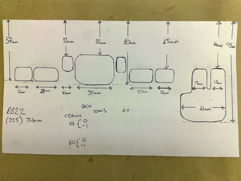

Port Maps - RB20/22/25 & TS1
As requestd....
TS1:
RB20:
RB22:
RB25:
Just a rough guide to each, for comparison purposes.

Top guide mate. needed an rb22 map a few weeks ago and here we are. cheers.
