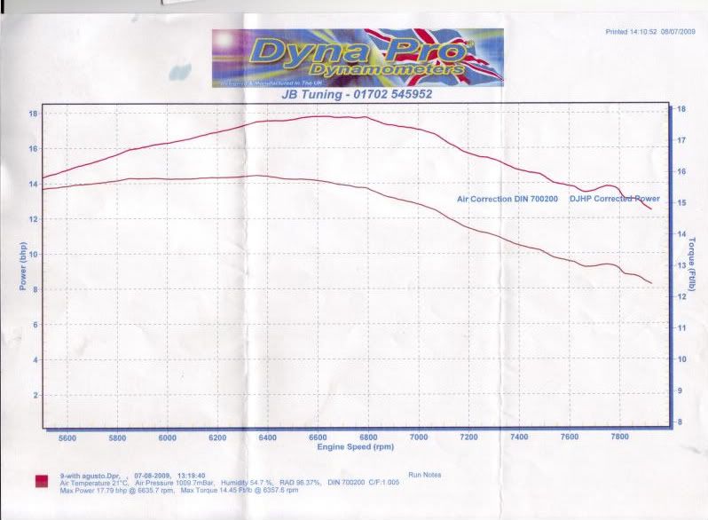

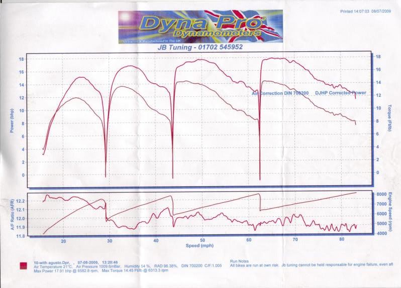

I swapped my Delly 30 for a Mikuni TMX 28 a couple of months back, also had a re-hone to 225 and some port matchings and polishing done.
I use to get about 130 miles from my 12 litre tank, but now get only 60 miles!
Rapido 200 Classic, JL3.
I had it on the dyno today.
Any ideas? Should I swap back to the delly?
