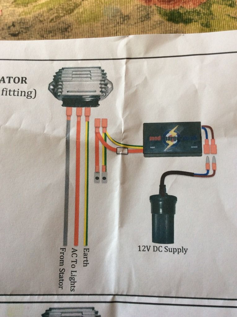

Morning, I was wondering, would I be able to use the DC output from this Modcharger to run my SIP speedo?

Mine does run on AC but I was hoping it might run a little better if on DC - it tends to fade a bit on tick-over - I just thought I would ask the question whilst I have my headset off to tidy up the electrics in there.

The rev counter needs an AC feed but the power feed can be either ac or dc. I ended up running off a battery which is charged by the dc circuit as tick over output wasn't enough to power consistently.
Sent from my SM-G920F using Tapatalk
Same as above I just put the Rev counter feed on the inlet side of my wassel

I have Wassel conversion and have spliced the tacho sensor into one of the yellows before the rectifier. Seems to work fine.
