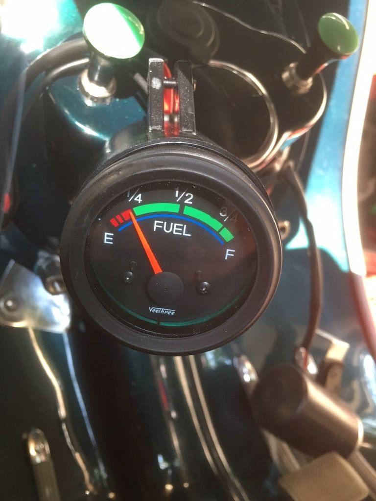

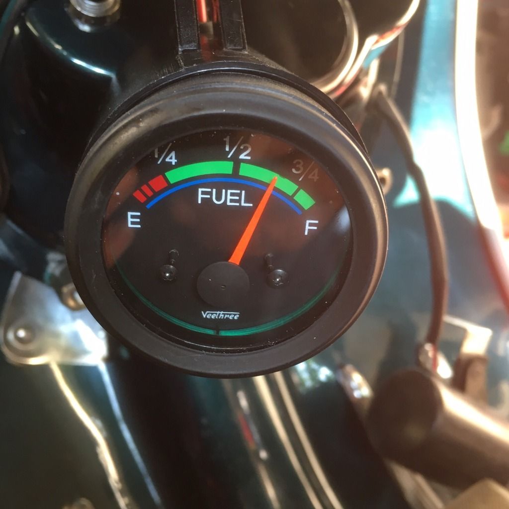

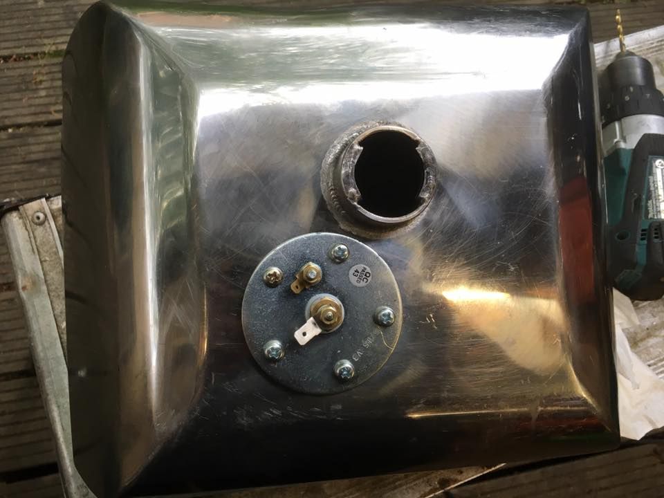

i have a fuel gauge fitted and working, i had to fit a sender unit into the tank, and i used a fuel gauge off a triumph motorcycle i also got a matching temp gauge. there are two types of sender and fuel gauge so be careful what you buy, the easy to wire type has an earth on the sender unit and one other wire which has a variable resistace, zero when its empty and the restistance rises as the float rises in the tank, the tricky type has two resistance wires, i couldnt get that type to work, i belive one wire sends the gauge up and the other sends it down, use the simple type if your going to fit one would be my advise, great having a working gauge though, you know exactly how much fuel you have.

all sorted now fitted a proper one, 4ish litres, 9ish litres and full about 12 litres works great

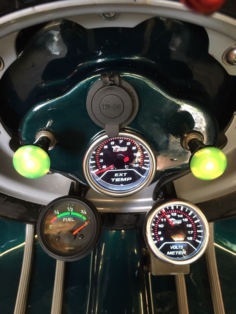

nicely done, a very welcome extra that makes life easier, heres mine
