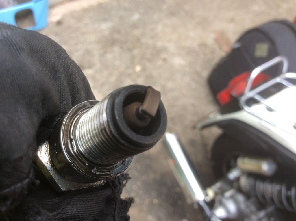

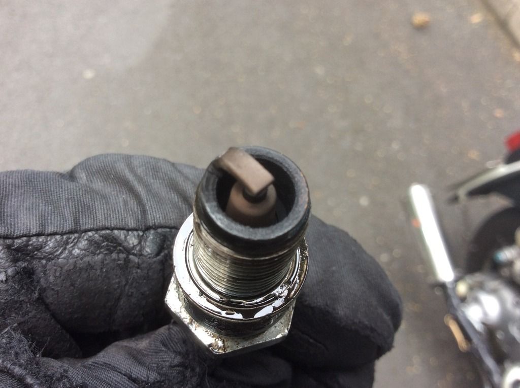

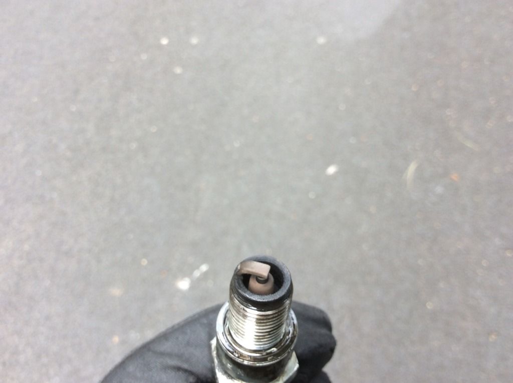

I've just raised the clip on my needle on TMX35 TS1-225. What's opinions (waiting for dyno trip, just want to make sure I'm running safe till then):

Too weak for me to feel comfortable with it.

Adam_Winstone wrote:Too weak for me to feel comfortable with it.
What would you suggest, lower clip again? It's on middle clip at the moment:
55 needle middle clip
320 main
Lambretta Series 2 Rat - RB260, SuperTourer, Cyclone 5 gearbox πŸ˜ŽπŸ‘
I would agree with Adam, that does look a bit week but what throttle position were you using before you took the plug out? were you doing plug chops at steady fixed positions of the throttle or is that just after general riding?
Chris in Margate
Posts: 379
"Whiter shade of pale"
Too weak for me.

Looks lean to me.........did you do a "before and after" pic ?
As said, was this after a little jaunt round town or some serious motorway riding ?

This was after a good thrashing around the back roads. I'll do some proper chops today, check it at different positions :D
I must admit though, the picture does look lighter than it really is ;)

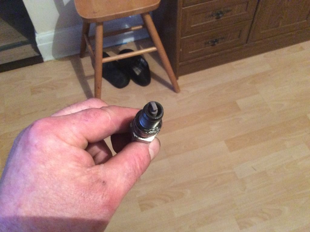

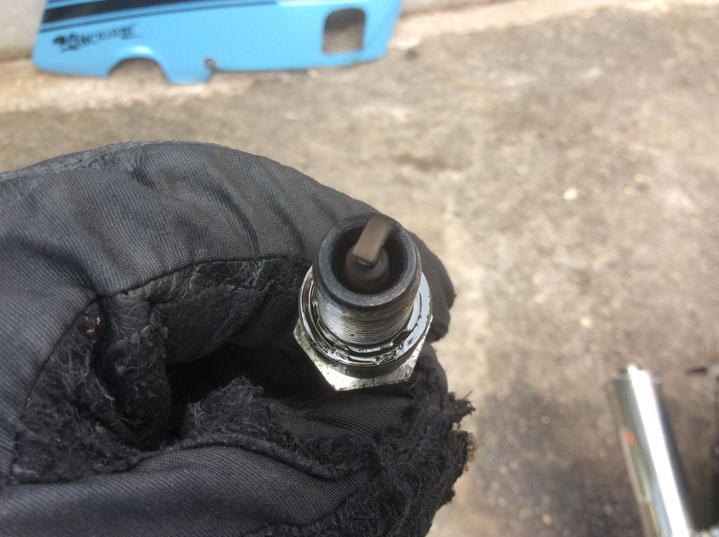

Lowered clip.....plug chop accelerating up a hill:
Then after a run, accelerating and stopping outside my house, probably about three quarters throttle:
Looks much better......what yea think :D
