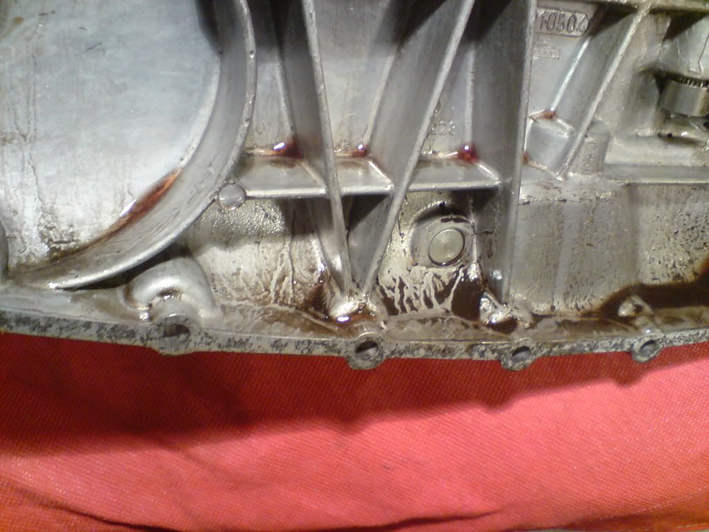

This is a picture of what was inside the SIL engine I bought Grit & Sand I put a post up a while ago about it but never put this picture up.... There was a fair deal of grubby stuff in the engine this was just the little that stuck to the inside of the case after the oil was drained...
IMO.... they need a good liberal coat of looking at before being run...
But still good value for money if you can get one..!!
