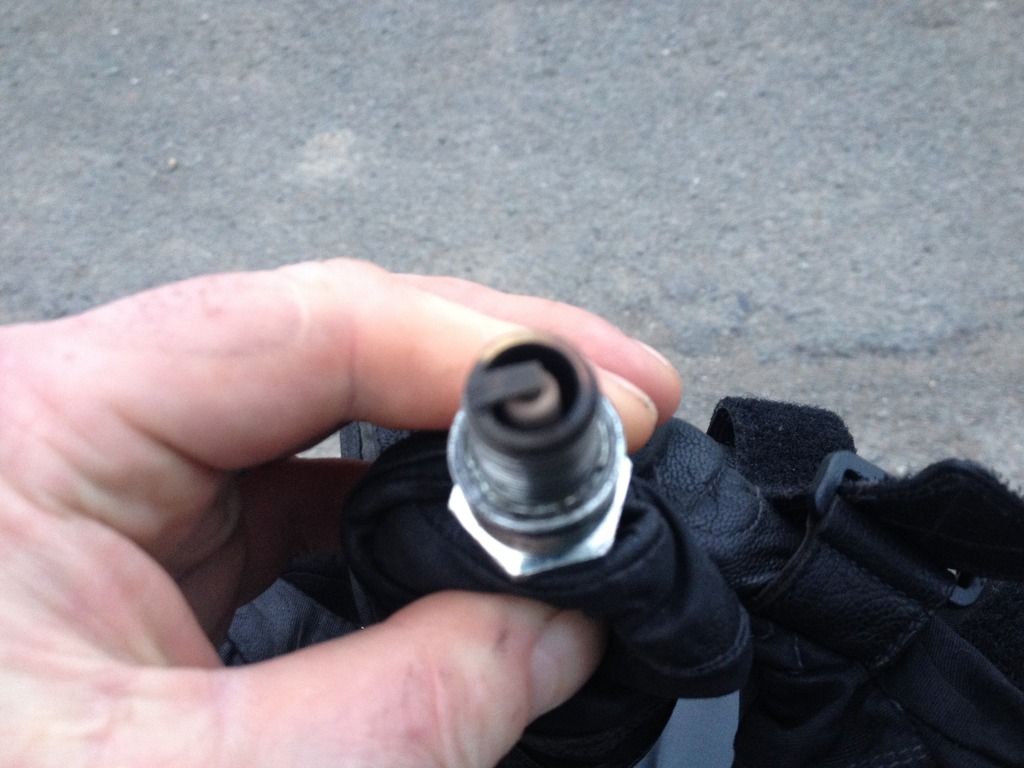

Thanks for the jetting advice, I have done what you suggested apart from I have a 320 in there as I haven't got a 325. Scoot runs great and did a plug chop on a dual carriage way going up hill so under a fair bit of load:
What do you think? :?:

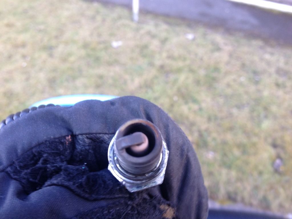

Went up to a 330 main tonight, runs great, CHT and EGT still relatively low (120 and 450) and the plug looks like this:
