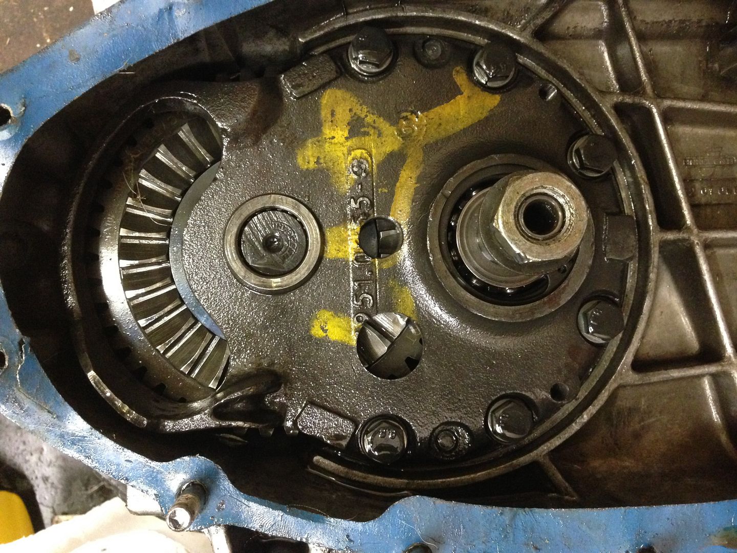

Im putting my 5 speed back in after an engine rebuild. Prevously iv faffed around with a camera phone, not ideal. I understand that by drilling holes in the endplate you can get a better view of the gear and christmas tree meshing. Has any one done this and if so where is the best place to drill out the holes. Dont really want it to be like a collinder... :D

Drilled the small hole to use an LED light and a dental mirror, with which i didn't succeed in anything other than frustrating myself.
Drilled the larger hole and did the job with decent lighting and no problems.

Cheers guys, i drilled the hole and brought the endoscope you reccomended.
