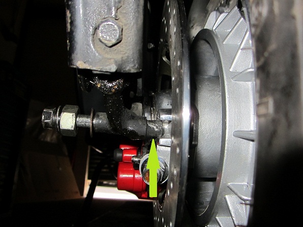

Hi.
I have to cut this piece of antidive to operate correctly?
Thanks!
Yep!
i know you do on lth type but before you do .. disconnect the tie bar and try to move the caliper up and down .. if it wont move then peg will have to come off
ArKaTxU
Posts: 340
Location: Rias Baixas
RICSPEED wrote:i know you do on lth type but before you do .. disconnect the tie bar and try to move the caliper up and down .. if it wont move then peg will have to come off
With the tie bar disconnected the caliper moves up and down without problem. The caliper part and the other part are independent.
jason frost
Posts: 485
No its just holding the speedo drive.
yes both halfs of the hub need to rotate its a shame to cut a set of jet links though

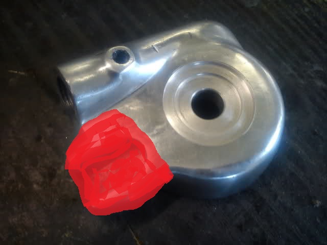

tea5ive
Posts: 575
Main scooter: cometa 140
dont cut the link stub, cut the locating slot off the speedo cover. check this post out as i did this to my set up, bare in mind i did not need the speedo drive for my aplication. http://scooterotica.org/forum/viewtopic.php?f=7&t=22610
shocky wrote:yes both halfs of the hub need to rotate its a shame to cut a set of jet links though
ArKaTxU
Posts: 340
OK, then i understand that both halfs need to rotate.
And if I cut the speedo part is ok?
What part stop the speedo part rotate free? the speedo cable?
Minority
Posts: 673
Main scooter: Li230 S3
As long as the caliper is free to rotate you shouldn't need to cut anything.
Minority wrote:As long as the caliper is free to rotate you shouldn't need to cut anything.
as i have said and have also repled on face book to say the same
