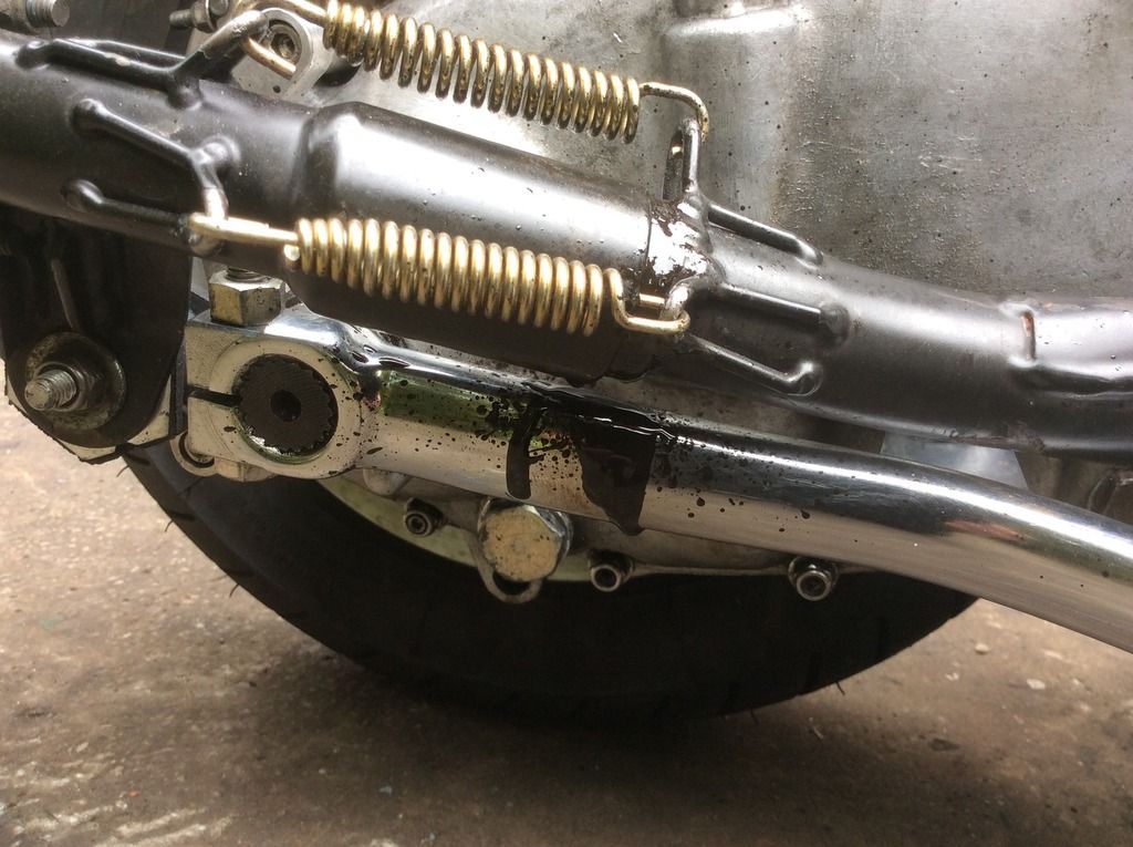

Just done some work on scoot and took her for a spin, when I got back this thick black oil was around the joint between exhaust and end can. Never had this before, is it simply the joint is leaking or anything else that might need attention?
Specs- Ts1 225, jl3, delly 30mm running rich at the mo till dyno next week :D

Don't see any copper RTV on that joint
alanscottj
Posts: 960
Grumpy225 wrote:Don't see any copper RTV on that joint
Just got some :D do I smear it around the muffler side of the joint then slip it together?

Copper RTV?Where did you get that from?
alanscottj
Posts: 960
dave411 wrote:Copper RTV?Where did you get that from?
V-tech copper RTV eBay

You can get a silicone slip joint to cover the joint , they sell them on e-bay and you can get coloured ones or black.

immylam wrote:You can get a silicone slip joint to cover the joint , they sell them on e-bay and you can get coloured ones or black.
You mean like this?

Not that one Alanscotti t does not fit the jl, well not mine anyway :roll: ,you need the readspeed one :)
