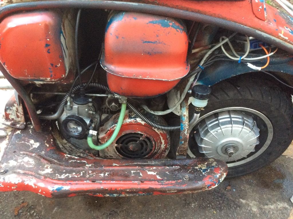

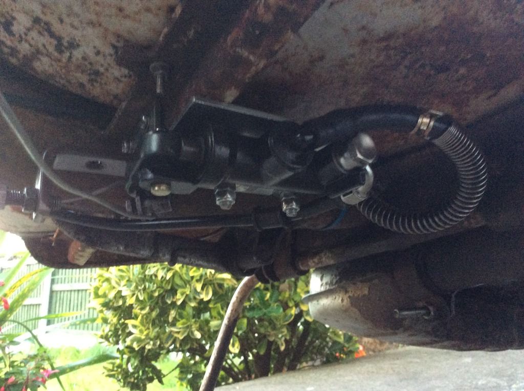

I have just put an hydraulic front brake on my series 2. I can't seem to get the brake fluid to move through the pipe, I am pumping the brake lever like mad and the level in the reservoir isn't moving at all. When I put one on my GP the reservoir was on the headset and I was able to bleed it really easy. Do I need to do something different this time given that the reservoir is far away from the hidden cylinder which is under the legshield opposite the brake.

Yeah, I have done that, the fluid filled the pipe between the reservoir and the master cylinder, I filled the reservoir again and refitted the pipe to the master cylinder. I thought that with the main pipe full it might start coming through when I pump the brake but no such joy, nothing :roll:

That set up looks an absolute nightmare to bleed.
is it possible to temporarily move the master to a position directly above the slave. If so cable tie the lever down, leave it alone for 24hrs and it should bleed itself.
