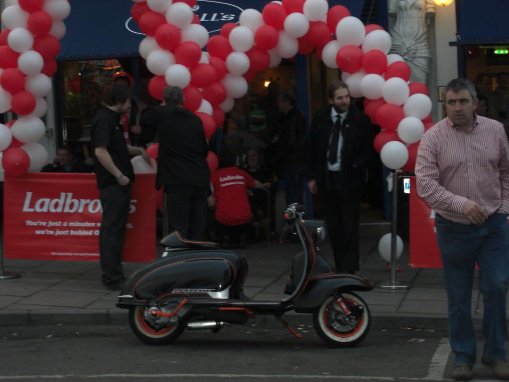

I'll report you in a few days.
I gave my exhaust flange to be matched with the cylinder.
It is the road version (JL3).
It will replace the Sito Ancillotti.
Some pics from other scooters.

those bushes on the shark fin bracket are rock hard and make the pipe shake to bits. buy the rubber ones from kegra and put heat proof cylicone on the slip joint.
rotate the silencer so it points to the right or fit a piece of rad hose to the end pipe or you will have a filthy scooter in two miles.
replace the end can bolts with ones double the length and put cylicone on the threads or the end can shakes apart.
