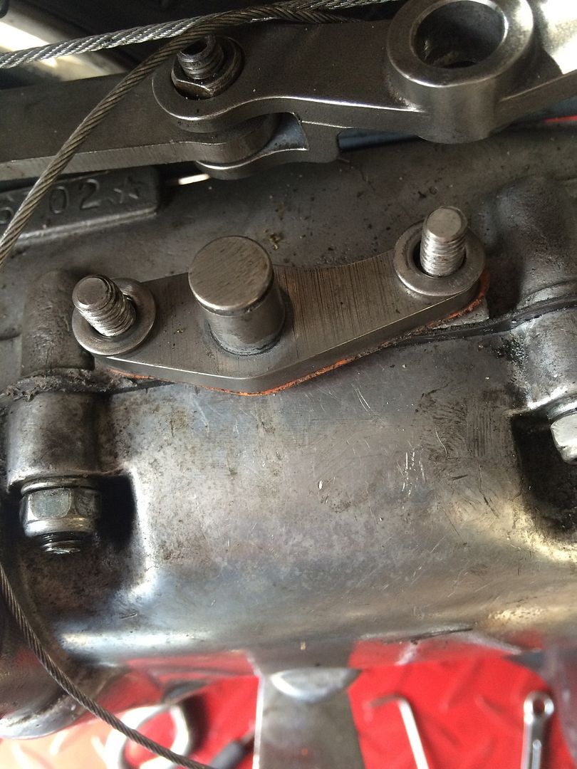

Does this look right? This is it in 2nd gear. Can't get 3rd or 4th :x
Much appreciate your opinion.

You have got cables the right way round , not back to front on the cable block ?? I did that once before could only get second then first gear :oops: :oops: col

Even without cables I can't get 3rd or 4th.

In second gear the gear selector should be in line with the crankcase stud in the picture

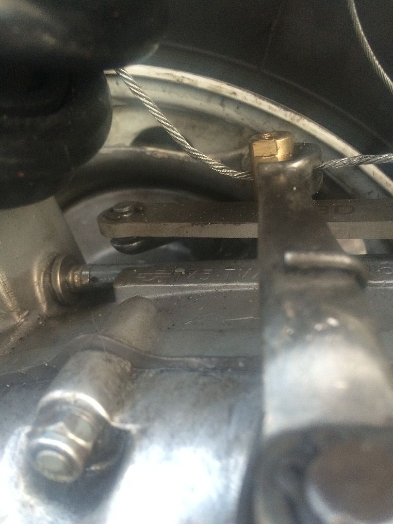

Is it this way....
Or this way :idea:

The second picture is correct. :)

HxPaul wrote:The second picture is correct. :)
Thank you sir :mrgreen:
