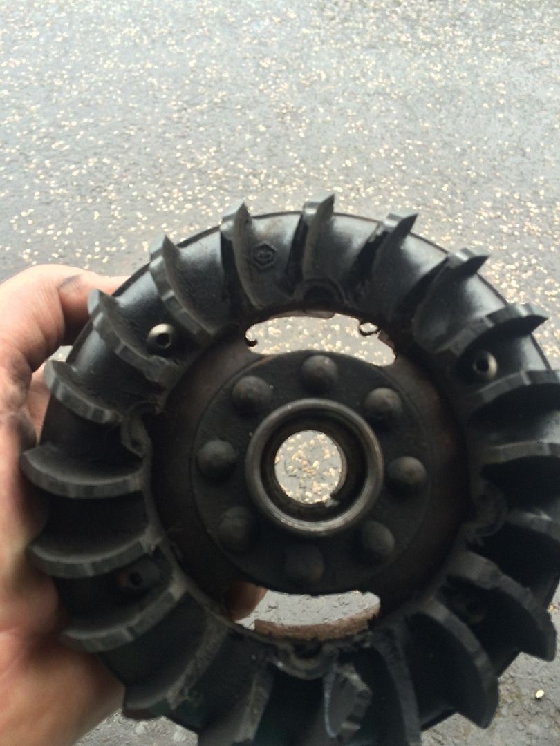

Where do I do purchase the bungs to cover the area where you use the holding tool on. Due to the plastic fan I can't get a dust cap on :|
Also it's a piaggio fan does anyone know wot it's off as Ive busted a couple of the fins :twisted:

Vespa ET 2 or 4 fans are similar,do a search .Easiest is to fit the dust cover first then machine the fan inner to fit over as the cover stops the flywheel threads rusting and filling with dirt.The bungs are Vespa smallframe or PX ones as there are two sizes.https://www.beedspeed.com/vespa-flywhee ... 20oi3pkae6 Is this the fan? https://www.beedspeed.com/automatic-fly ... 20oi3pkae6
