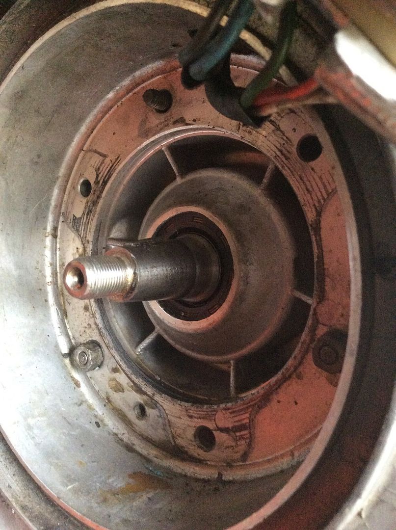

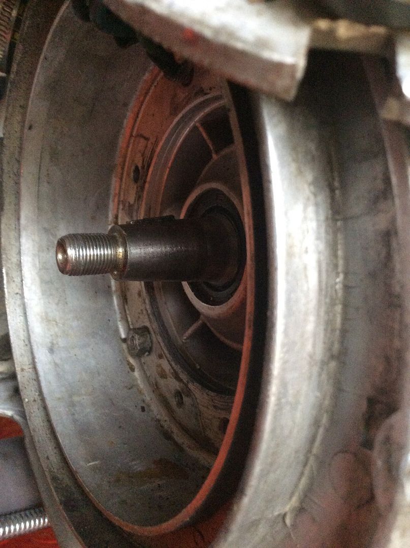

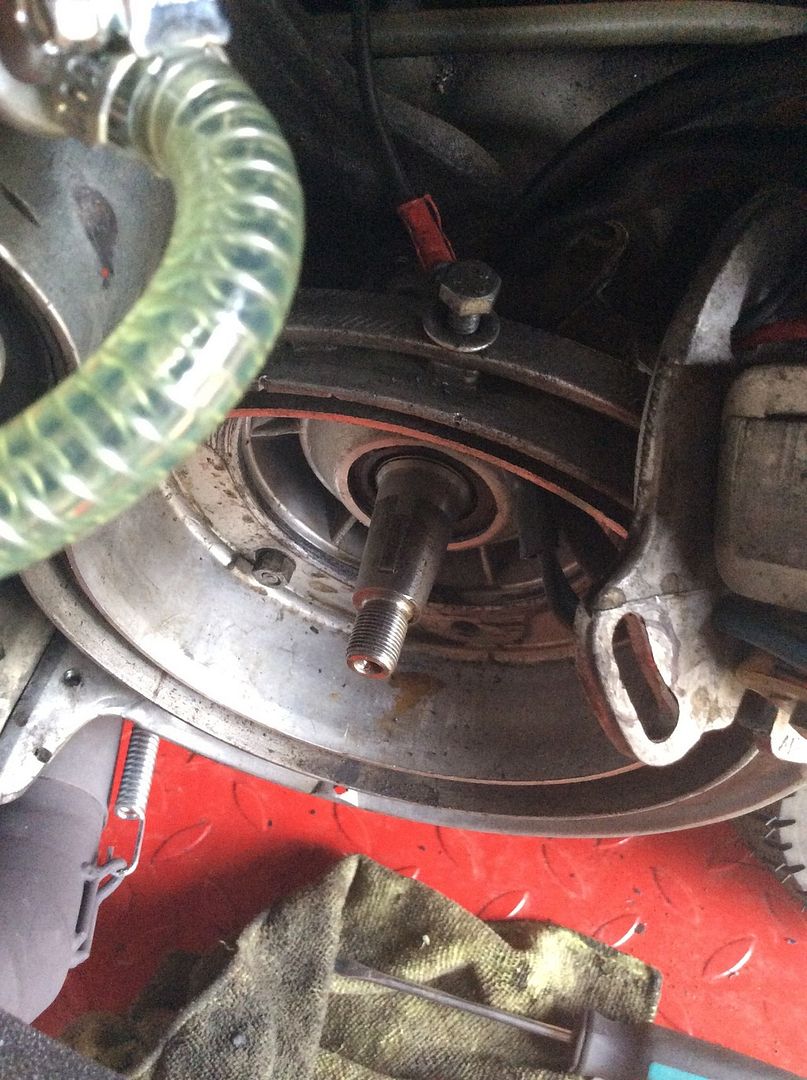

I want to fit a Varitronic electronic kit to my scooter as the Indian one has died somewhere so I thought I'd upgrade. The motor is a 190 built by Harry Barlow from an Italian Li150 S3 but I'm not sure on the crank identification, ie is it GP or Li?
Can anyone identify it from the pictures I've taken of the taper? Want to avoid buying the wrong kit!

Thanks both,
Li/SX it is then.... Wanted to double check as I was told it was unlikely that Harry would build an engine using an Li crank..... Not in this case it seems!
How long ago was it built , the previous owner might have swapped a high spec crank over before selling this engine !
What sort of 190 is it state of tune etc it could just be a rebore slight tune and not have anymore power than a standart 200 plenty run 200, s on li style cranks
