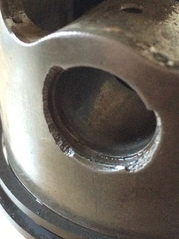

HOWEVER! Just fitted the rings to the piston, getting everything ready to refit and got two new piston circlips out of my stash to fit and found this! Can't believe I didn't notice the damn thing on disassembly! That'll be a new piston then!
Donnie.

Whats caused that then ?
Donnie
Posts: 1038
Location: Bedford, UK
good question, it's an indian 3 ring piston, dunno if they suffered quality issues at any point or not, but there's no scores in the barrel at all, so can only assume either it disintegrated slowly or if in chunks he was lucky enough that they escaped out the exhaust port!

got one the same - 3 ring piston (cant remember what make) - it also hads small bits missing from between the first and second ring groove.
the barrel had slight scoring but nothing you would have worried about and head was perfect
was still running (a bit rough mind !)
