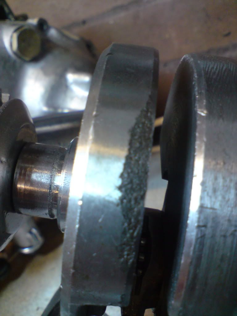

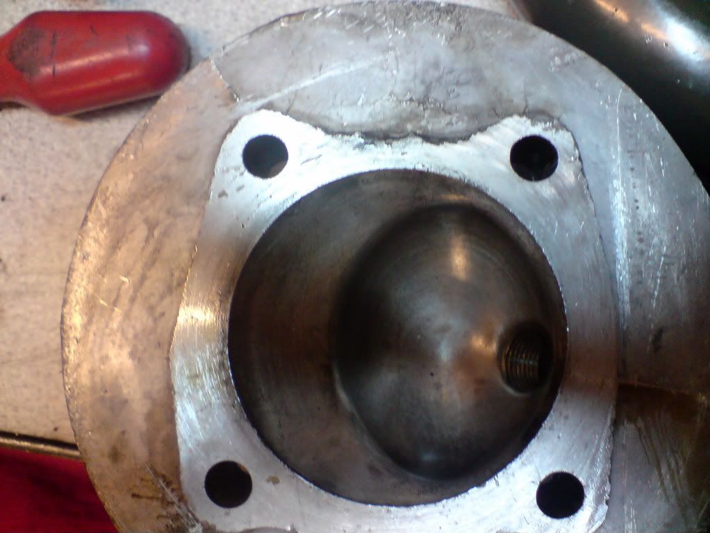

The Cylinderhead has a poor gasket face on one edge ( badly cast )... I will try to post a photo ... The crank is also missing a small piece of Crank web, again... photo needed...But I dont think it will effect the running.... The small end bearing was covered in grease and grit...... Yam 110 rod to be fitted...

Two photos to show what I tried to describe....
The first is the Crankshaft which looks a little substandard...
And the second showing the Cylinderhead with a poor gasket face..... :shock: ...
