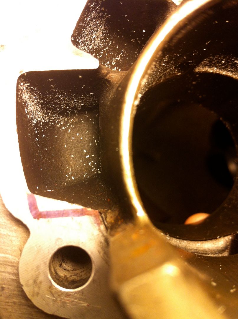

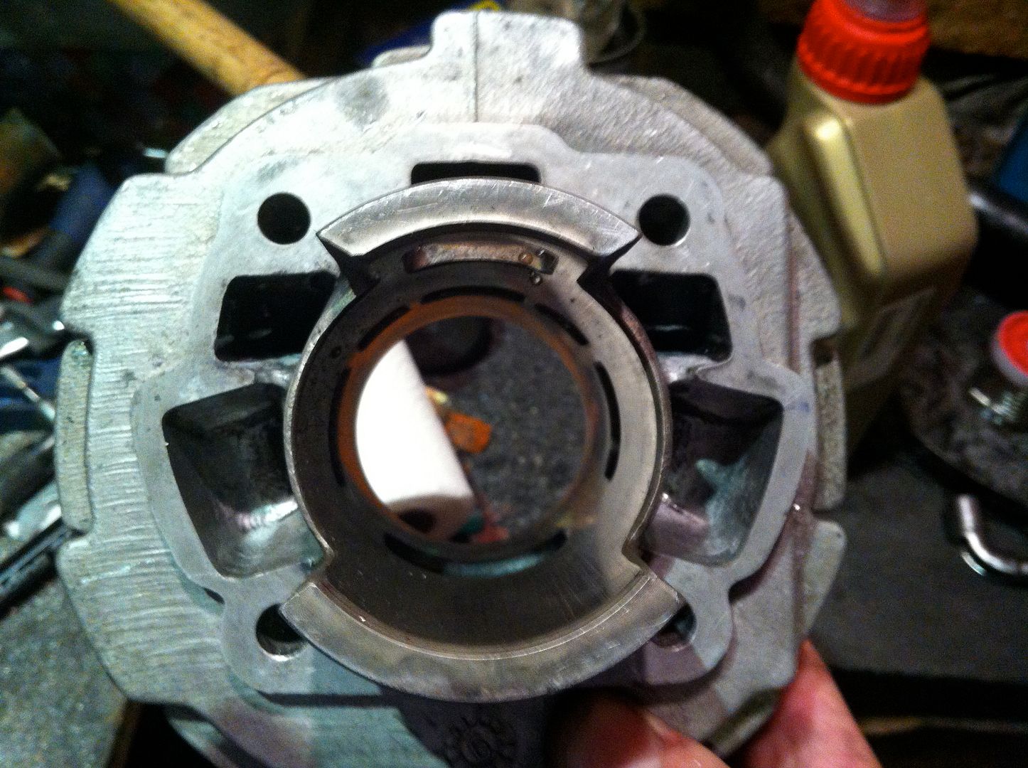

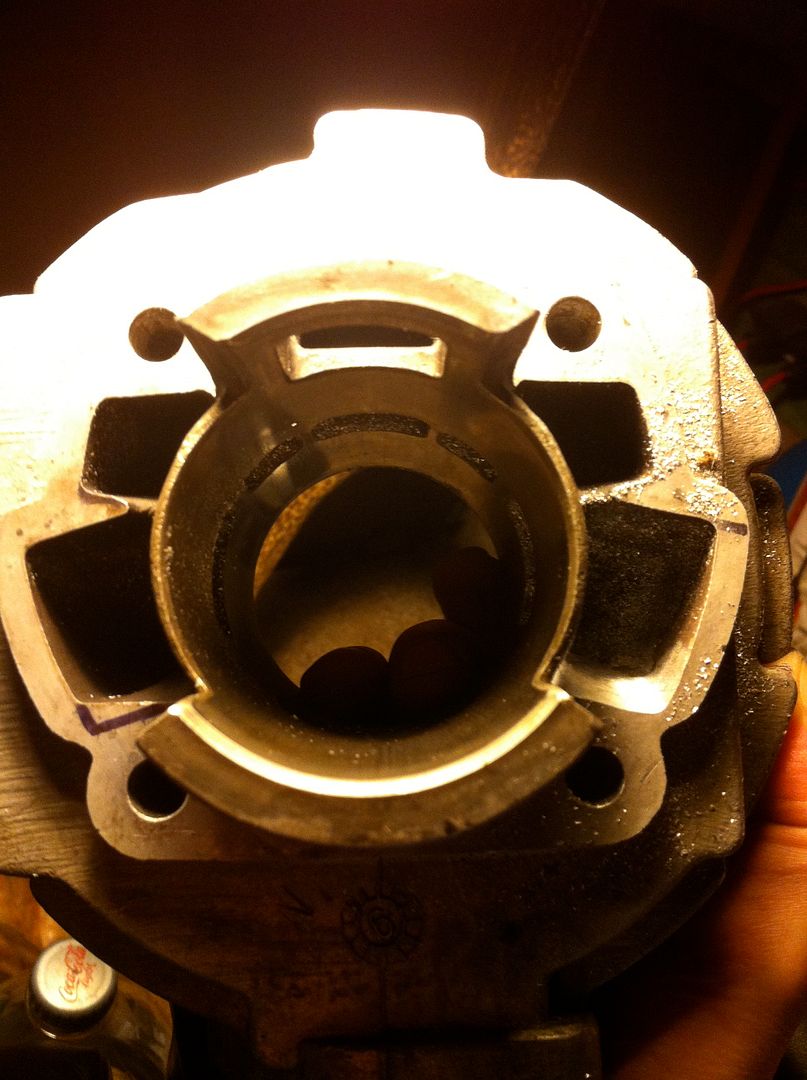

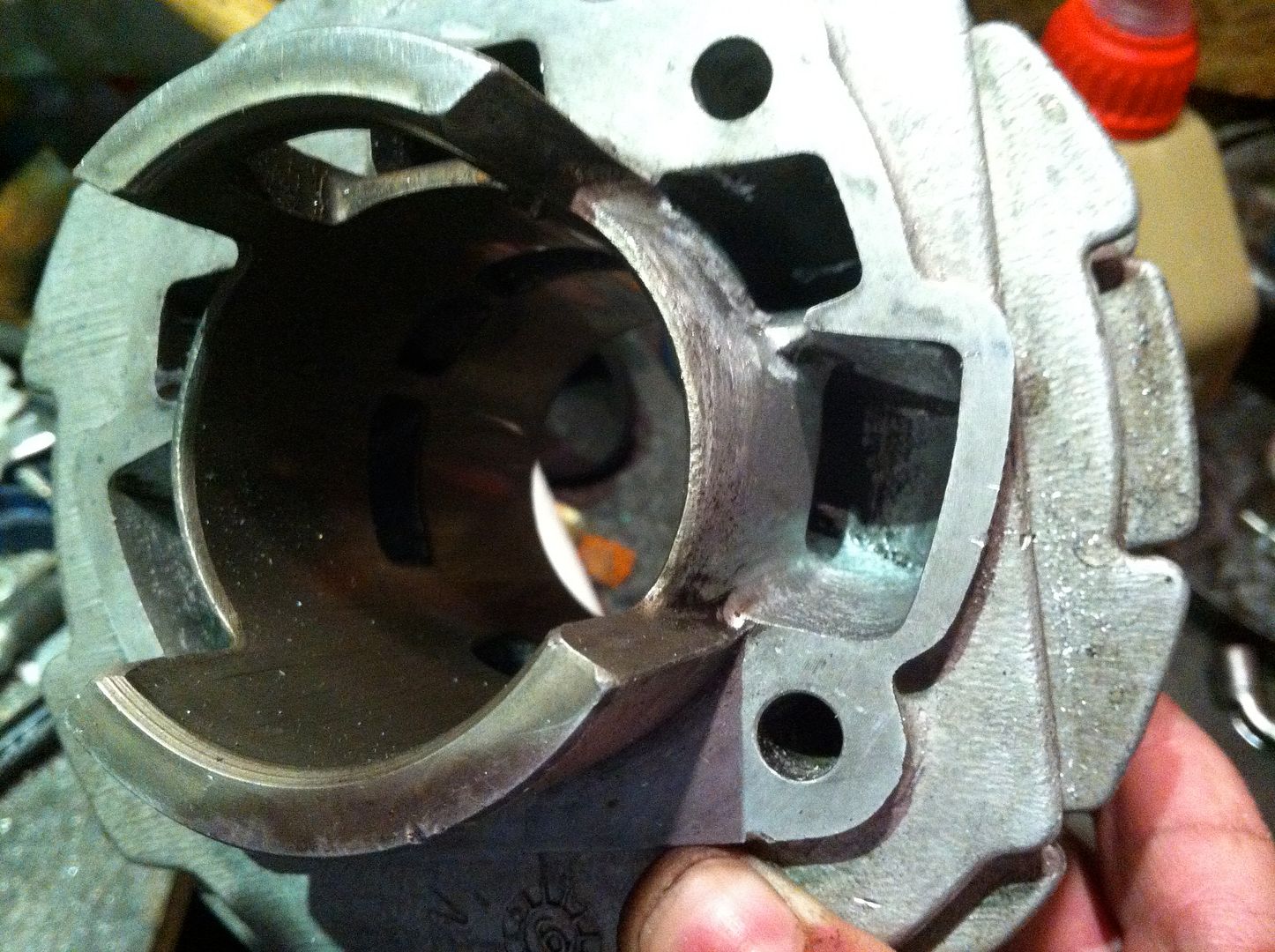

Begining of the porting job:

This ones looking like is coming on. What kind of rev range are you looking for with this one? Interested in your chosen crank inlet timing and transfer port durations. Are you re you going to get in the barrel and reshape the transfer port roofs or are they ok? Can't quite see in the pictures.

for the T5 barrel transfer roof seem ok. But with 3mm less of wall thickness,auxiliary and boost post that both have very slopy roof, will need to be reshaped and a bit reprofiled.
