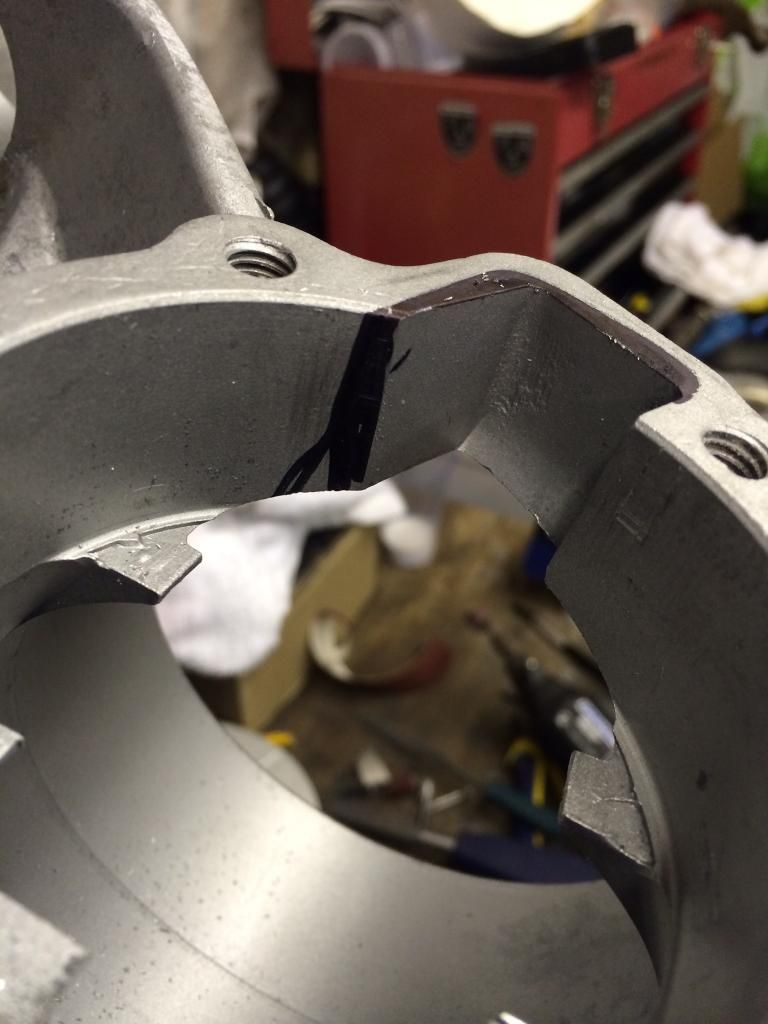

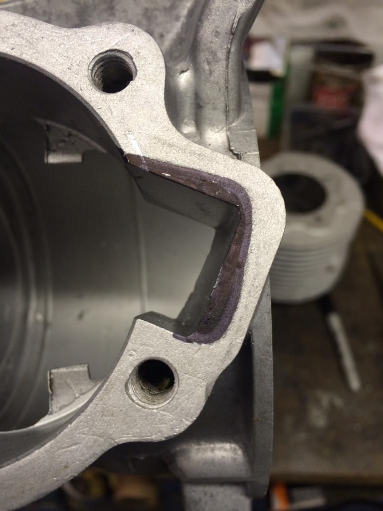

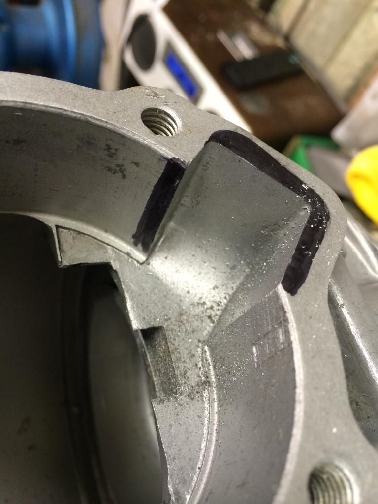

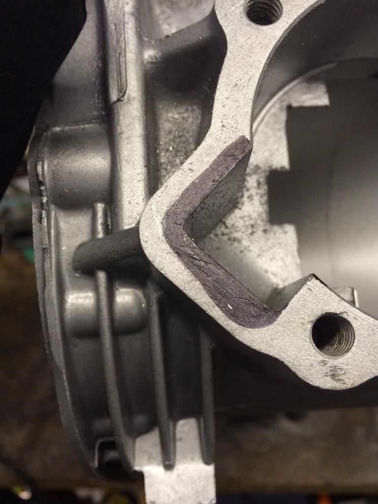

Hi all,just getting the cylinder prepared for rebuild.I have matched the inlet and exhaust ports to the manifolds,now I am wondering about the crankcase.You can see in the pictures the black areas are where the cylinder fits in the crankcase,should I remove these or leave as is?
I am really not sure about this,as the way I am thinking is that 1,yes it will give a bigger and better fuel flow,but 2, it will decrease crankcase compression as I am removing part of the crankcase and making it larger.What are your thoughts?

Whether you'll actually notice the difference is debatable, but anything that improves the flow will help. It will slightly lower the primary compression, but you're only removing a few ccs of metal so probably not by much.
Don't forget to put the mag housing in and blend thtransfer cut out on that too, fit it with studs on and scribe it so you always put it back in the same place.
I'd be a bit careful with the drive side one looking at how you've marked that up as it looks a little close to the edge. This can crack.
Two rules -
Measure twice cut once.
You can take it off but you can't put it back.

Yes,it is a bit close isn't it.Didnt know about the mag housing so thanks.Will check that later.
