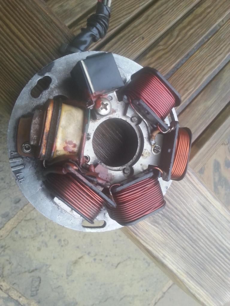

just got to the stage where I would like to carry out this conversion, but is it as simple as the Lambretta stator conversion.
So I this conversion is possible and I can't see why, is it the mucky looking white wire on the clockwise coil after the pickup, that I unsolder and connect to the wassel unit and do I leave the thin copper wire earthed, as is?????
Below is the actual PX200 stator.
Thanks
ArmandTanzarian
Posts: 1103
Location: Kent
It looks like its the one at 3 o'clock.
At the moment, one end of the string of lighting coils goes up to the regulator and the other is earthed. You have to disconnect the earth and then connect it to the other input of the Wassel.

I cut the one that ArmandTanzarian pointed out (at 3 o'clock) and joined a blue wire to it. So that means there are 2 blue power wires and one black to ground. I am using a cheapy ATV/mini bike regulator/rectifier and very happy with it so far.
