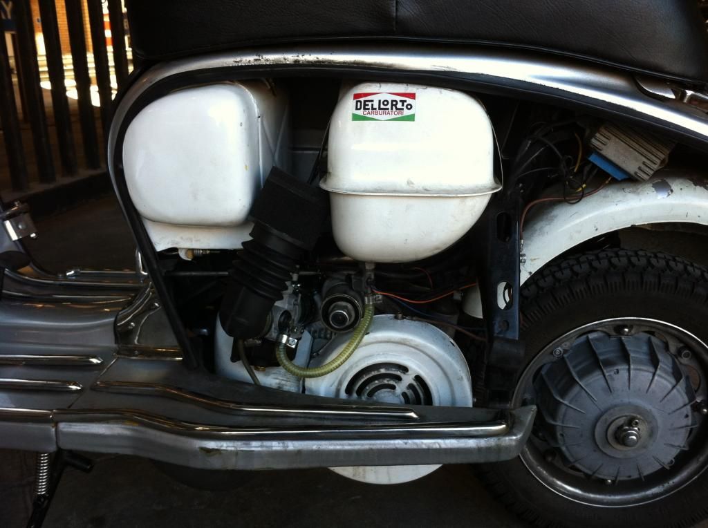

I tried this and it did drain but not sufficiently enough to allow me to jet the carb. I'd bought the bellow/ramair combo from MB and ended up cutting off the filter and clamping to a bellmouth on the carb and cutting a hole through the side panel. I've probably got the drain in box somewhere if you want it... it's basically a small brass fitting and drain tube that fits into a 3mm hole at the bottom of the bellows.
Architecten
Posts: 106
Joined: Tue Apr 29, 2014 1:10 pm
Main scooter: Allwyn Pushpak GP125 (RT200)
Location: Wirral
Here it is in action...
