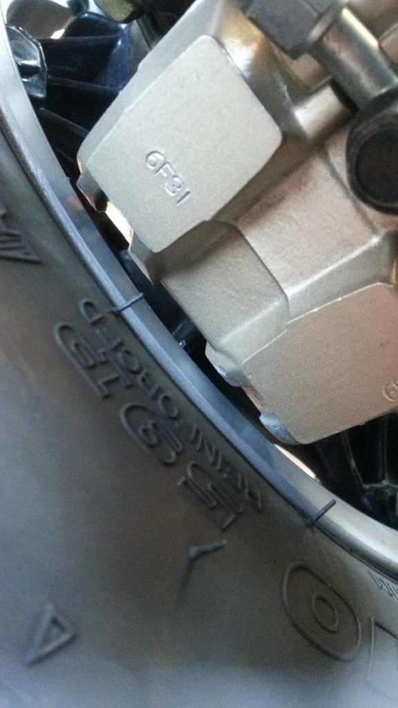

Do either the AF or Sip rims fit with the scootrs disc brake

I've got the SIP rims with my ScootRS outboard disc and there is a little bit of grinding to do on the back of the caliper. I'd consider it minor "fettling".

hi have SIP Tubeless and they fit o.k. with a scootRS with anti-dive no problems

Cheers for that. I have the scoot rs anti dive with the red caliper so will take my chances. It will fit or i will make it fit

I've got a ScootRS hydraulic disc on two scooters, one with AF and one with SIP rims. Neither one rubs.
Posts: 2591
Minority wrote:I've got the SIP rims with my ScootRS outboard disc and there is a little bit of grinding to do on the back of the caliper. I'd consider it minor "fettling".
Definitely the exception and not the rule.
