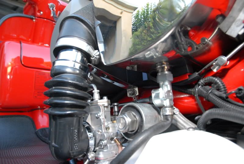

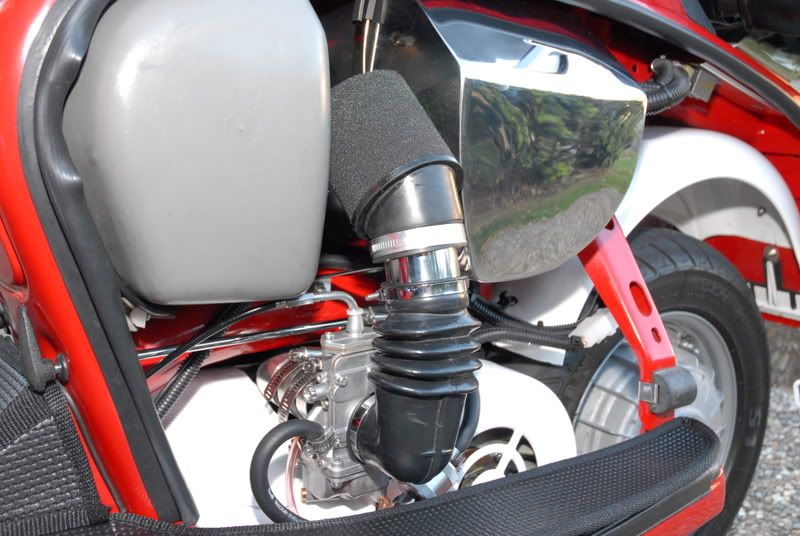

Really? Here is my set up,I thought I would have some trouble due to the fact I made my own fuel tank,but no.
What tank,rubbers,fuel tap,manifold do you have?
I hope your gonna sort the kink in the fuel pipe ;)

this is on a series 1 with the stock lever which i've shortened and made into a male end to fit the fast flow tap which is in the stock ser. 1 fuel tank. this is a mbd manifold and mbd tour rubber. i'm starting to wonder if part of the problem is the scootrs fuel tap lever surround. while it looks really nice and matches the choke lever base, maybe t's restricting me from turning the lever to the angle i need.

Byron, i don't think that will help me, thanks though, that is a nice set up.
nice tank on yours Redghost.
