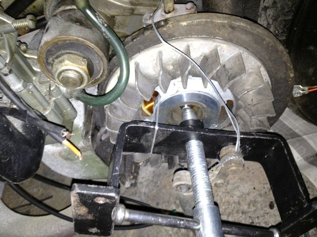

Helping a mate set his timing and the threads are knackered on the boss......any tips or alternatives for removing the flywheel ? Only option i think of is welding a nut on the boss and running a bolt through....

2 or 3 legged puller?

That got mentioned Joe but I wouldn't have thought you could get them in the windows with the stator being in the way.....unless there is a "Lambretta puller" out there ?
I'd try another puller first and make sure it's a good quality one

A friend of mine try the clutch tool in an unorthodox way: and it worked fine.....

BTW, welding the nut on gets my vote if a better puller doesn't work.

phil23fair
Posts: 143
Joined: Wed Mar 02, 2011 7:59 pm
Main scooter: Lambretta Li 250 Special
I saw Harry Barlow tack weld the puller into the flywheel boss and remove the flywheel in the normal manner. He then cut the tacks away and removed the puller. Because the puller was a long way into the boss there was still plenty of thread left on the puller so it could be used again. The boss was knackered so a replacement boss was going to be fitted. Scooter restorations sell replacement bosses.
