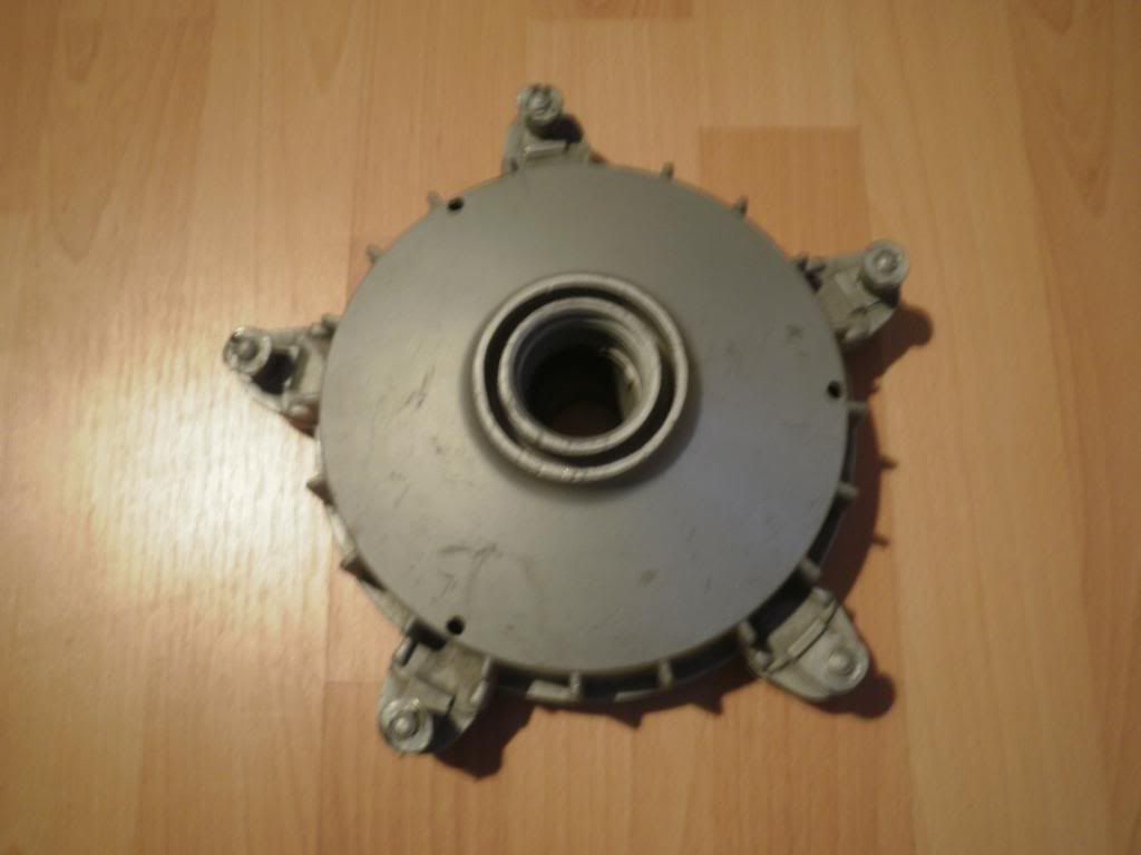

Can anyone identify this Vespa front hub?
Herman
Posts: 183
Joined: Thu Feb 16, 2012 9:58 pm
Main scooter: GP200
Location: Lower Saxony
Im trying to identify this Vespa front hub (If the photo is uploaded!) The part number on the back is 991835. I'm presuming it is a PX or poss PK hub but can anyone confirm what it is either way?

Looks like a PK to me :!:

defo pk

Thanks both for the answer. As a second point, do PK's use the same hub. So would this fit a 50 and a 125?

Only the XL2 varients, the first series PK and XL 50's used a V range type fork and small drum front hub.

PK 80-100-125 ...which has got the px style fork set up it will fit
