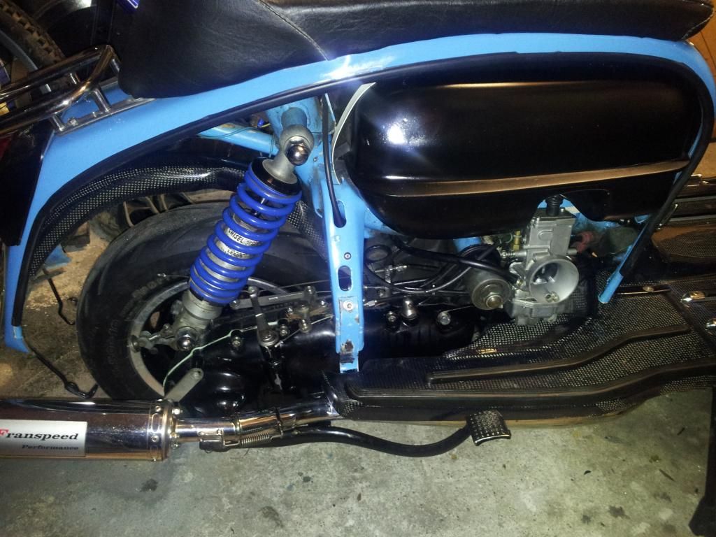

I have a diablo tank which he made with a small toolbox in the front. Don't need a rear exit fuel tap for a ts1 but might make pipe routing easier.

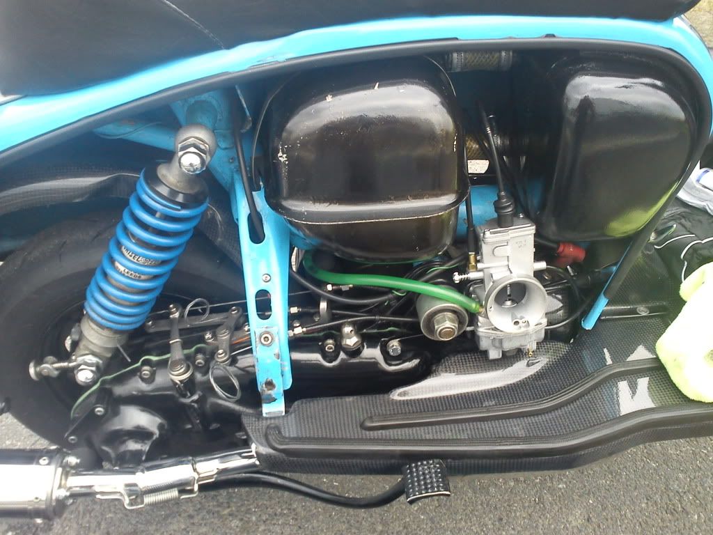

this is my tank 18l fibreglass from beedspeed cut outs on both sides simple fit extra long tank straps and your tank rubbers,or this is a twin tank convertion i had done 13l keeps standard look can use any size carb both sides still got it
