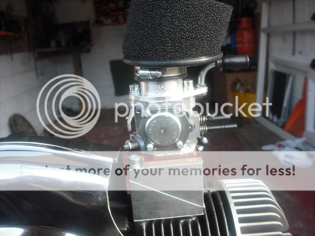

hi guys has anyody used a tillotson carb on a px any info pics etc appreciated.

i think that american vespa chopper that was on the front of scootering about 4-5 years ago had one on it, was about 14ft long and black?
ducksta
Posts: 1129
that was my project it was the pinasco one that martin at chislespeed had a right problem with pinasco got involved got it sorted but you dont see the kit on sale think they pulled it
