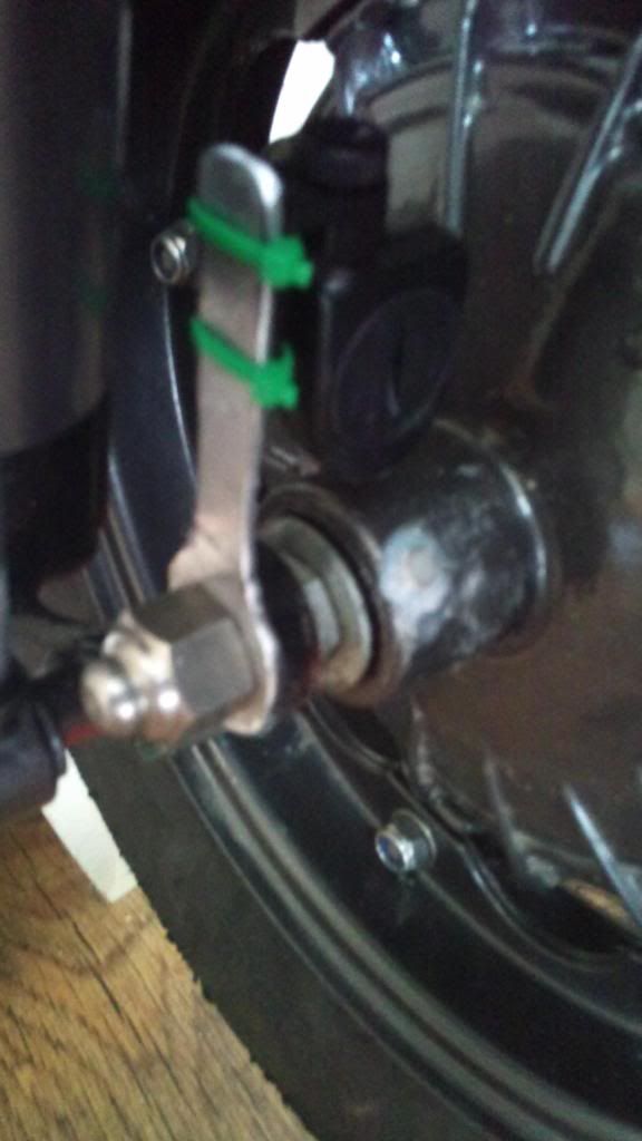

As I have a SIP speedo I'm looking for some ideas on how to mount the sensor for the magnetic pickup.
Has anyone made it work with an inboard disk hub ?
I was sure I saw somebody had done something clever like putting it in the original speedo drive hole but can't find the thread?
if I recall it was Jason frost ... magnet mounted and glued into the nylon drive of the main hub .. sender in the cable /gear hole

that's how i did it with a pushbike speedo .. didn't have to be pretty as its just for mot really

Didn't occur to me that you could use the grease nipple on that side...that might work.

Here's the thread you were thinking about, don't know if he ever got it working but it was a really neat idea!
http://scooterotica.org/forum/viewtopic.php?f=7&t=25920
and here's another one for mounting on the rear wheel, similar, but not the same as my mounting.
http://scooterotica.org/forum/viewtopic ... 34#p193334
