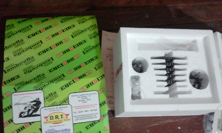

The cyclone arrived in October and after some alteration to Tino Sacchi kickstart shaft (too long, it catched the fisrt gear when engaging the kickstart), my friend fitted it following the clear instruction booklet that came with the gearbox package.
We shimmed it with 1mm washer using a new standrd gear selector spring.

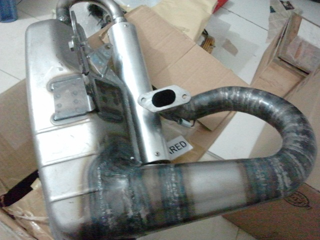

I fitted the Cyclone on my LI 240 (race tour 240, vhsh carb, bgm ingnition with a mid-weight flywheel). At the same time i tried the VNR/Mitolambretta pipe, seen on this forum some time ago.

After a brief warm up i went for a ride on the road, there was too much traffic so i shift up very slowly, but i already heard something different in the engine.....the revs never went too low after a gear shift.
Then i wanted to fully realease the quality of the gearbox, so i went for a smaller road with no traffic....i opened the throttle in second gear shifting up at about 6000 rpm, gearchanges felt so gorgeous, the engine never lose revs and i felt like driving an old Aprilia RS, in the forth gear i realised how fast i was going on that poor road conditions, and i had another gear to engage yet!!!
Gearchanges were really fast with only small movements on the handlebar, great feeling i never missed a gear!
I just went for a quick blast and came back after 20 minutes.....i didn't want to get off the Lammy, i was so excited!
When talking to a friend after his test drive, he told me that in the years he fitted variuos cylinders, carbs, ignitions, pipes, but nothing seemed so innovative like a close-ratio 5 speed gearbox in the scooter world.

I'll be fair.....i was too much concentrated about the Cyclone and didn't care the pipe performances.
I was astonished when started the engine....it was so quiet!! Quieter than a original pipe!
The engine was shifting up so lovely but i revved it only till 7000 rpm. I think the pipe shuold be involved in the quality ride described above!
On the next weeks i had i'll dyno the engine to compare this last pipe, to the previous and to a Gori 50mm pipe the didn't had the performances i expected.

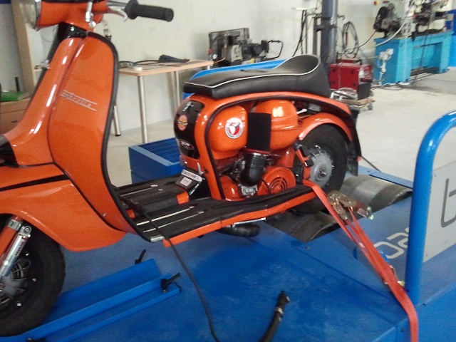

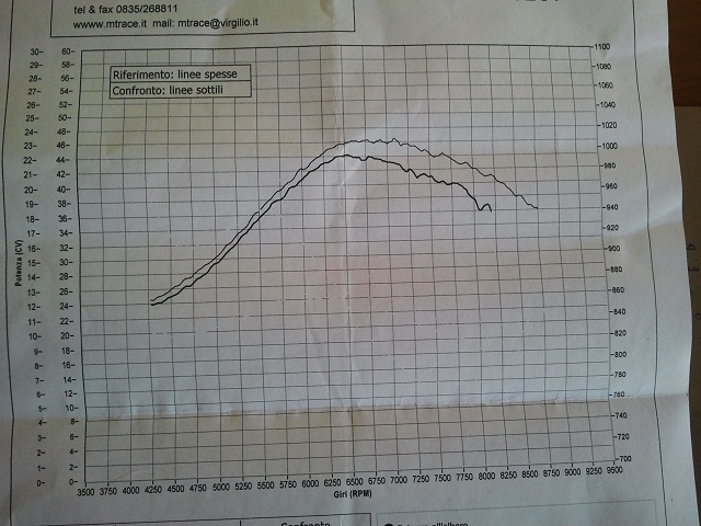

I've dynoed the Lammy today.
On the first run with just the new exhaust, it gave 2 cv more than the previous pipe and 2,5 cv more than the 50mm Gori.
On the second run after setting up the carburation, it gave 3,5 cv and 1nm of torque more than the previuos pipe and something about 4 cv more than the Gori.
On the ride back home it seems a totaly different engine...now the pipe pulls till 8000 rpm and with 5 speed box it's very simple to reach high speeds.
On the graph you can see only the hp curve of the first run and the second one after setting the carburatoration.
I'm sorry for the quality of the graph, the ink in the printer was low....
23,2cv @7099 rpm
25nm @6300 rpm
